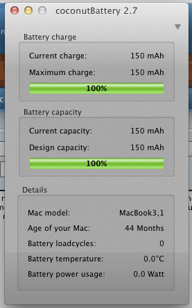

ThirdSmile Posted August 21, 2011 Share Posted August 21, 2011 SmartBattery works as expected. Tested on SL 10.6.7 with AppleSmartBattary.kext from dsdt_battery_meter_fix_juanerson_08_2011.zip. CoconutBattery screenshot. http://zxbodya.cc.ua/notebook/Screenshot20...t11.20.33PM.png Also I have added fix for propper showing design capacity: Store (\_SB.PCI0.LPCB.EC.C1E1, Index (PBIF, One)) /* Line added, C1E1 - stores battary design capacity */ /* Store (Local0, Index (PBIF, One))*/ /*removed because: Local0 now stores current(not design capacity) */ UPD: Battery load cycles, incorrect now(it was correct before with AppleACPIBatteryManager, or probably was like correct one). Link to comment Share on other sites More sharing options...

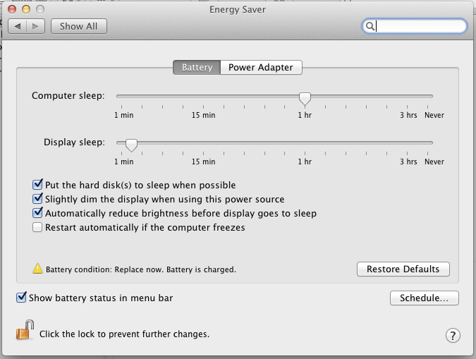

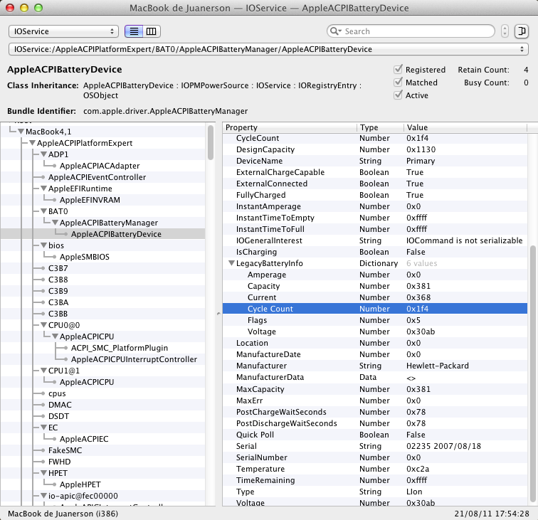

juanerson Posted August 21, 2011 Share Posted August 21, 2011 Load cycles are working fine here in Lion & Snow, BUT ONLY by using AppleACPIBatteryManager.kext. Lion capture 0x1f4 = 500 hexadecimal (Num of battery cycles, I think is real because is almost death). Same report in Snow, by System Profiler (status "Replace Now") and information in coconut battery 2.6.6 app. Also "replace now" in Lion prefpane. Also, I made a little update to my previous comment... I think now is better code... just details to be perfect for all of us. @ThirdSmile, Thanks for the find about C1E1 for design capacity. I will test it, and try to add to the Lion - Snow fix battery code, for properly functionality in both Systems. EDITED: DONE! worked beautiful for me, added the fix (Lion ready) to the Update 1 involved dsdt code in the previous post. Link to comment Share on other sites More sharing options...

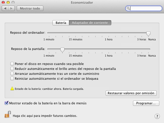

Zprood Posted August 22, 2011 Share Posted August 22, 2011 Hi guys, what a good news about Battery information. And i follow what you introduce to do, get this result: 1, Battery menu bar shows normally with the native AppleACPIPlatform.kext. But some bugs exists like the picture shows, the message "Condition : replace now " do not appears under SL, with CoconutBattery monitoring, the battery capacity is not correct. Also, system profiler doesn't shows battery information in the Power item. Here is my dsdt file: dsdt.aml.zip Link to comment Share on other sites More sharing options...
