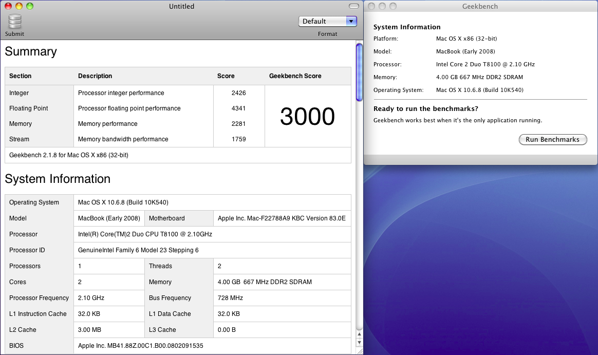

alemate23 Posted July 3, 2011 Share Posted July 3, 2011 Hi guys. I've question for Juanerson. I've read all of your post with your geekbench. Mine are 2149; i've a genuine hp 6720s (intel core 2 duo 1.4 ghz version) with SL 10.6.8. What is the best configuration (DSDT, smbios, ecc...)? How can i reach your score? Link to comment Share on other sites More sharing options...

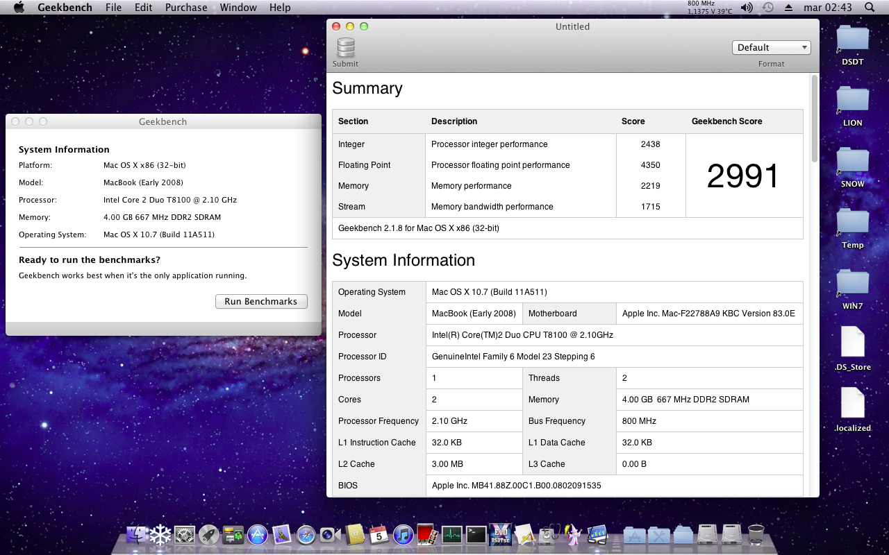

juanerson Posted July 4, 2011 Share Posted July 4, 2011 Guys, because 10.6.8 is the definitive Snow Leopard build/version, and after CPU upgrade... Now, I have a new full genuine profile (MacBook4,1), and getting native SpeedStep directly by the modification of the .plist inside /S/L/E/IOPlatformPluginFamily.kext/Contents/PlugIns/ACPI_SMC_PlatformPlugin.kext/Contents/Resources So, bye bye legacy injector. Same way I have implemented SS for Lion (from DP2), as BlackCH said. My results (limited wrong FSB). EDITED: Added Lion score (cosmetic FSB from smbios.plist): alemate23, I think your score is relatively proportional to your hardware configuration. Because, my score average always was 2440 (Core2Duo T5470 1.6 -- 1800 MHz IDA activated)... by using DSDT v0.20 + MB3,2 profile + legacySS.kext. P.D. Just at this moment, after two days attempting the download... I will go to install/test the Lion GM. Link to comment Share on other sites More sharing options...

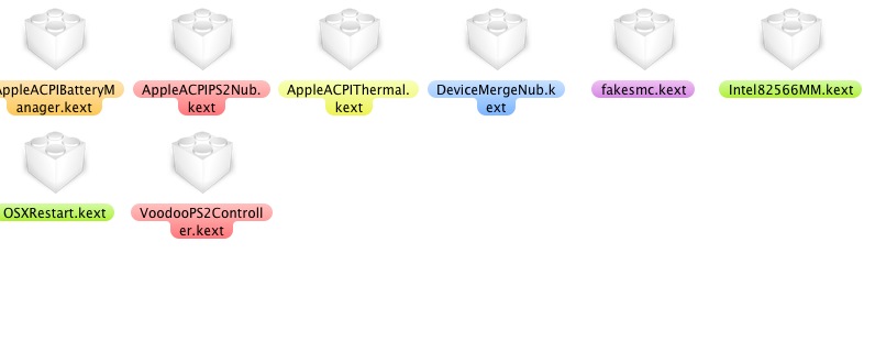

alemate23 Posted July 5, 2011 Share Posted July 5, 2011 @BlackCH You can solve your Bluetooth keyboard setup wizard problem with this Lion install and boot, but touchpad don't works! What kexts have you installed in Extra/Extensions? I've (see image) Nothing in S/L/E Link to comment Share on other sites More sharing options...
BlackCH Posted July 5, 2011 Author Share Posted July 5, 2011 @BlackCHYou can solve your Bluetooth keyboard setup wizard problem with this Lion install and boot, but touchpad don't works! What kexts have you installed in Extra/Extensions? I've (see image) Nothing in S/L/E good tip. Thanx! VoodooPS2Controller.kext inside S/L/E. No PS2Nub kext. Use this: http://www.insanelymac.com/forum/index.php...t&p=1423196 Link to comment Share on other sites More sharing options...
juanerson Posted July 5, 2011 Share Posted July 5, 2011 @alemate23, if use chameleon 2RC5, which has restart fix by default, then you do not need OSXrestart either. Also, ACPIBattery and ACPIThermal are unnecessary at moment, you know. Even, it can brings problems if you use those .kexts. Link to comment Share on other sites More sharing options...

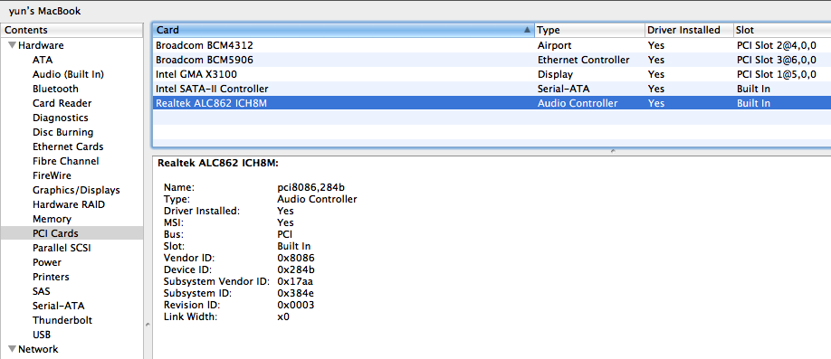

alemate23 Posted July 6, 2011 Share Posted July 6, 2011 Yes, I use the Macbook3,1 and the CPU speedstep works well, here is my setting file.Macbook3_1.zip Thanks Juanerson and others. Thanks Zprood. Also audio works with VoodooHDA, but don't use the .pkg or you'll get a KP. Use kext utility and remember to delete AppleHDA. Link to comment Share on other sites More sharing options...
Zprood Posted July 6, 2011 Share Posted July 6, 2011 Thanks Zprood. Also audio works with VoodooHDA, but don't use the .pkg or you'll get a KP. Use kext utility and remember to delete AppleHDA. Actually, my laptop isn't HP 6520s, 6720s, 6820s....etc. And my audio card is ALC861-vd which can use patched AppleHDA.kext. So thanks anyway. My hardware is similar with HP 6520s..such as: ICH8M chipset, x3100 graphics and so on. Link to comment Share on other sites More sharing options...
