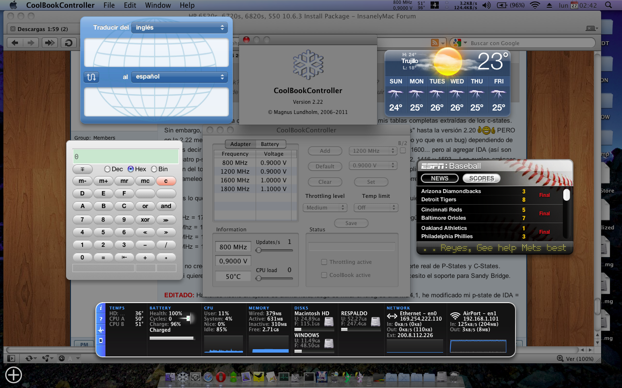

Hi Friend, +200 points in geekbench?... Then, I almost sure they are broken your C-States to hardware level (not IOReg)... So, more heat near to +5C. BTW, if you notice all THIS, therefore please type in terminal: ioreg -lw0 | grep AICPMVers
But the output is not real/true support. I think is a problem between Chameleon + Update + SSDT. Please see my new version of the legacy injector for speedstep, has some effective changes... check "info.plist" inside. Also, please see my smbios.plist and c.a.B.p for better General results-performance on my system. Attached my DSDT (experimental) JUST FOR REFERENCE about my own C-States addition (for my CPU), and other things on GFX0, SBUS, Scope PR, etc.
Alternatives to fix more heat problem: GenerateCStates in c.a.B.p OR inject in DSDT extracted the custom table SSDT-5 (from chameleon) using DSDTSE. The reason why, both native DSDT caller method (CSTH) and native SSDT table (_CST) not worked here. Just want to say I am using Chameleon 2RC5 rev1037, because C2RC5 r755diffv7 has full hardware support (and +150 points) BUT have not Prelinked kernel option. Please report. Good Luck.

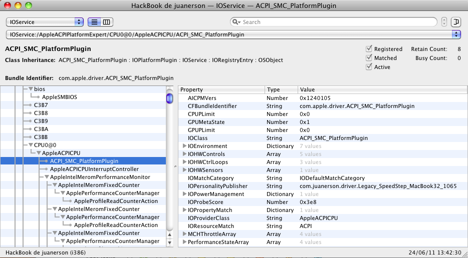

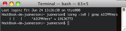

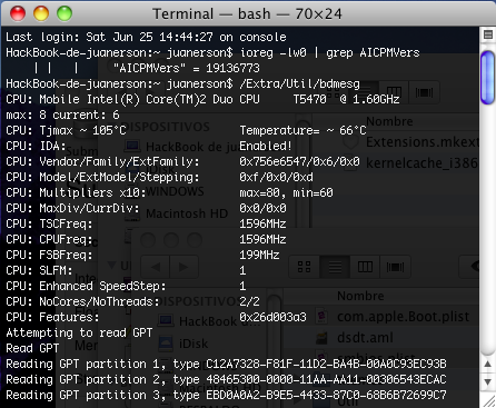

My terminal output after patch my dsdt. Very different to IOReg w/new legacy, to the right:
Captura_de_pantalla_2011_06_24_a_las_13.35.48.png Captura_de_pantalla_2011_06_24_a_las_13.46.04.png
carpeta_sin_t__tulo.zip

Si, Chevere! Me muestra quietos los p-states, y excelente temperatura con mis tablas completas extraídas de los c-states. Sin embargo, debo mencionar que no tuve ningún problema de "velocidades" o "lecturas" hasta la versión 2.20 ;) PERO en la 2.22 me lee valores ajustados (tal vez ficticios) por interpretación de software (creo yo que es un bug) dependiendo de IDA, es decir si quito 1800 mhz en la DSDT entonces toma correctamente 800, 1200 y 1600... pero al agregar IDA (así son mis cuatro p-states de fábrica) coolbook 2.22 me indica cuatro cifras distintas 708, 1062, 1416 y 1593... Los cuales erróneos NO son del todo, ya que resultan exactamente a partir de un mínimo extraño ratio/multiplicador (5) x 177 (el FSB) regulado por chameleon para mi CPU por decirlo de alguna forma, hasta el máximo detectado correctamente (9) para IDA.
Esto es lo que me muestra coolbook 2.22..., un jaleo aceptable entre chameleon (cualquier revisión), y su aparente bug:
708 MHz = 177 x 5. Sería 800 MHz si el FSB fuese 200 x 4. Aunque 6 es el mínimo según INTEL... y algo de factor Ram?
1062 Mhz = 177 x 6. Este sería 1200 HHz.
1416 MHz = 177 x 8. Este sería 1600 MHz.
1593 MHz = 177 x 9. Y este sería 1800 MHz.
En fin, no creo que sea algo grave. Sólo errores de lectura. Pero jamás de falta de soporte real de P-States y C-States.
P.D. Si quieres te adjunto la versión 2.20 de coolbook. Esa es perfecta para mí. No necesito el soporte para Sandy Bridge.
