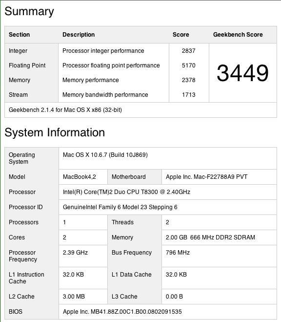

ThirdSmile Posted May 8, 2011 Share Posted May 8, 2011 C2RC5 r755 diffV7 just AWESOME for me. Now bring to me the correct detection of my CPU Bus and memory type/freq. So, finally a proper hardware full support to my configuration, therefore much less cosmetic injection on Profile (smbios.plist) and the better part is +125 points in geekbench (32 Bit). RECOMMENDED. I also have tested it. It did not bring to me the correct detection of my CPU Bus and memory freq. But after installing, notebook has better perfomance - shorter boot time(I think 20-30% faster), and bit better Geekbenck test results ~30 points. I also recommend to use this version. Link to comment Share on other sites More sharing options...
BlackCH Posted May 9, 2011 Author Share Posted May 9, 2011 C2RC5 r755 diffV7 just AWESOME for me. Now bring to me the correct detection of my CPU Bus and memory type/freq. So, finally a proper hardware full support to my configuration, therefore much less cosmetic injection on Profile (smbios.plist) and the better part is +125 points in geekbench (32 Bit). RECOMMENDED. Here is good too. Memory, FBS and CPU detected automatically. +100 points in geekbench 32 bit Gracias por el dato! Link to comment Share on other sites More sharing options...
juanerson Posted May 10, 2011 Share Posted May 10, 2011 Black, una auténtica bestia tu máquina en comparación con la mía Y Con ese perfil Te felicito nuevamente! Saludos. Link to comment Share on other sites More sharing options...
BlackCH Posted May 11, 2011 Author Share Posted May 11, 2011 La verdad que valió la pena el cambio de CPU! Pero aun sigo usando tu plist para el speedstep (editado para que cargue con macbook4,2). Por alguna razon funciona mejor. He estado haciendo algunos tests con 10.7, todo funciona bastante bien, salvo las zonas termicas. Habria que ponerse en contacto con prasys para ver si nos puede dar una mano con esto... En mi opinion, sin las zonas termicas funcionado correctamente no convendria correr 10.7 en estas maquinas... quizas se pueda solucionar editando la tabla SSDT correspondiente? Link to comment Share on other sites More sharing options...

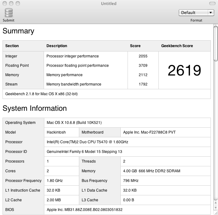

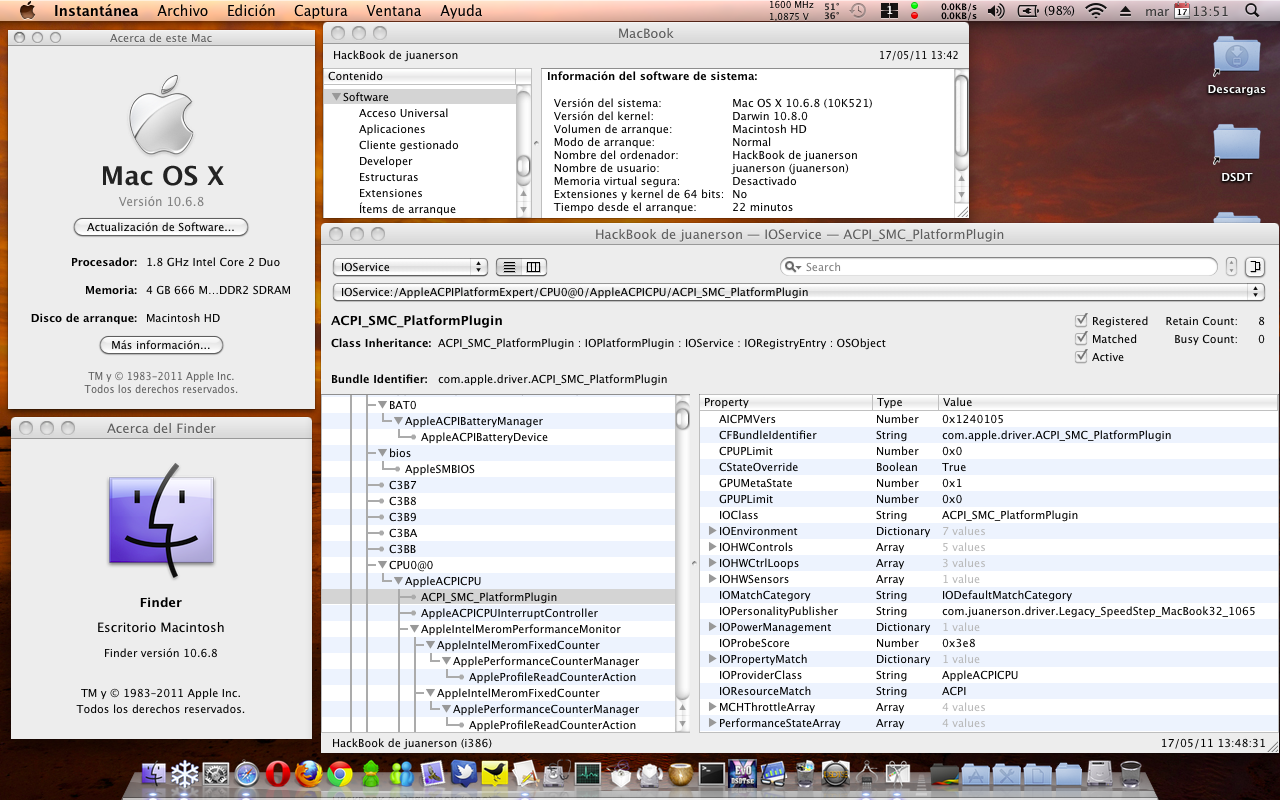

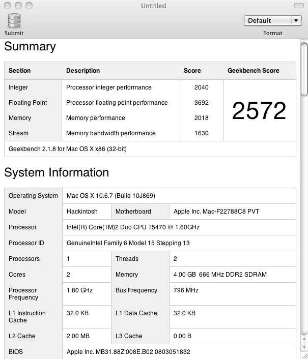

juanerson Posted May 17, 2011 Share Posted May 17, 2011 10.6.8 with some "internal" vestiges of Lion. Definitely very important to consider changes in IOReg. Better performance too. EDITED: Yeah better performance... BUT BUT BUT more heat (4-5C), also audio stuttering problems... Then, believe it or not the reason why is THE 10.6.8 UPDATE (LION'S HEART) BROKE MY NATIVE C-STATES SUPPORT (FROM PROCESSORS SSDT TABLES), AT LEAST CONCERNING TO HARDWARE LEVEL (NOT IN IOREG INFO). Just in case, I can confirm is not related to the Fake Profile (MB3,2), because same symptoms happens using MB3,1 (/S/L/E vanilla profile modified-touched). So, that's a very strange thing because it worked perfect until 10.6.7 (I mean Yesterday ). But the good new is than can be solved by adding the chameleon flag from /Extra/c.a.B.p: <key>GenerateCStates</key> <string>Yes</string> Bad DSDT? Bad SSDT? I don't think. But Snow (10.6.8) and Lion being problematics for ACPI (remember fan control and battery meter are not working in 10.7). Another point, what about the "pcidebug" entry in almost all devices in ioreg, what that mean? What do you think guys? BTW, even with the exactly previous Score, I am much more happy, with the same temperatures than before, and now I have no problem with this update The predecessor of Lion. P.D. Será que por ahí vienen los problemas de reseteo de la BIOS en 10.7, por rompimiento de los C-States? Ni idea Link to comment Share on other sites More sharing options...

juanerson Posted May 23, 2011 Share Posted May 23, 2011 Thanks yushir for the info... I will try the mirror thing. BTW, for native SpeedStep just the same legacy injector we are using from 10.6.5 + MB3,2 set profile in /Extra/smbios.plist you know, even works for 10.6.8 (2nd beta). Nothing different in the info.plist from 10.6.5... so, nothing to change about it, and always working as expected. Link to comment Share on other sites More sharing options...
