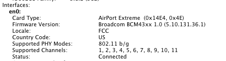

My choice was the Broadcom 4312 mini-Pcie (SPS# 441075-002) because passed the 6720s whitelist, and is native AirPort (but third-party). So, I know basically any 4311+ can be rebranded (from linux) to genuine AirPort Extreme card following the prasys's method. Now, by reference HERE and HERE you have the broadcom list supported in 10.6.4 (and 10.6.5 10H563), taken from inside /S/L/E/IO80211Family.kext. Saludos.

The link of the guide: Rebranding Broadcom 802.11a/b/g/n Cards as Airport (courtesy by prasys). Quote: "I’ll be showing you on how to rebrand a Broadcom card which OSX detects as a Third Party Wireless card to Apple’s genuine Airport card."

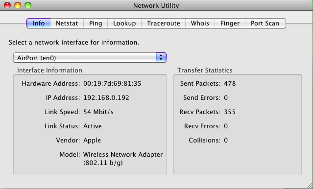

I've just flashed my machine with the hacked BIOS provided in juanerson's link using the DOS method. So far all fine! I will try to do the wifi rebranding now to check whether the whitelist check is bypassed or not. Cheerz!
EDIT2:
Everything works as spected!

Hay una linea en la guia de Prasys que hay que cambiar:
http://git.bu3sch.de/git/b43-tools.git && cd b43-tools/ssb_sprom && make
por
git://git.bu3sch.de/b43-tools.git && cd b43-tools/ssb_sprom && make
y esta me dio problemas:
ssb-sprom -i ssb_sprom_copy –-subv 0×106b –-subp 0×0087 -o new_ssb_sprom_copy
debe ser
ssb-sprom -i ssb_sprom_copy --subv 0x106b --subp 0x0087 -o new_ssb_sprom_copy

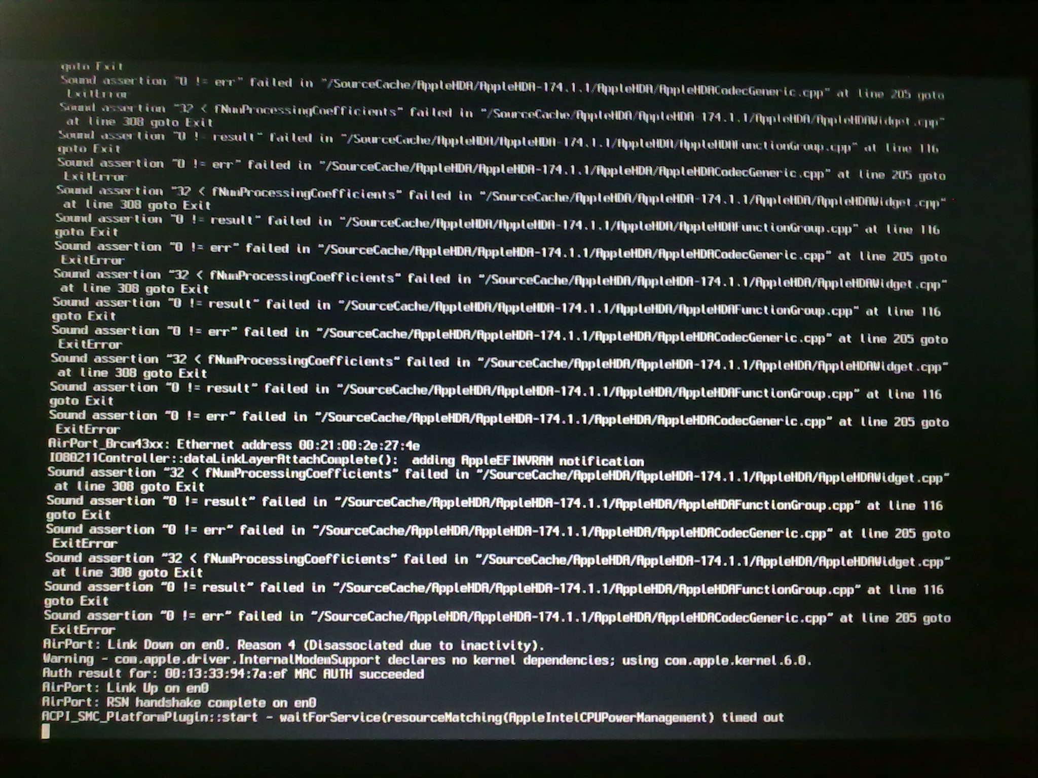

Hi, guys! I have a big problem.
I updated the BIOS. Now I do not normally work fakesnc
I can not find his normal version. And if I'm not going to remove and replace dsmos on fakesmc, you can not upgrade to 10.6.4
Can you help me with fakesmc?
