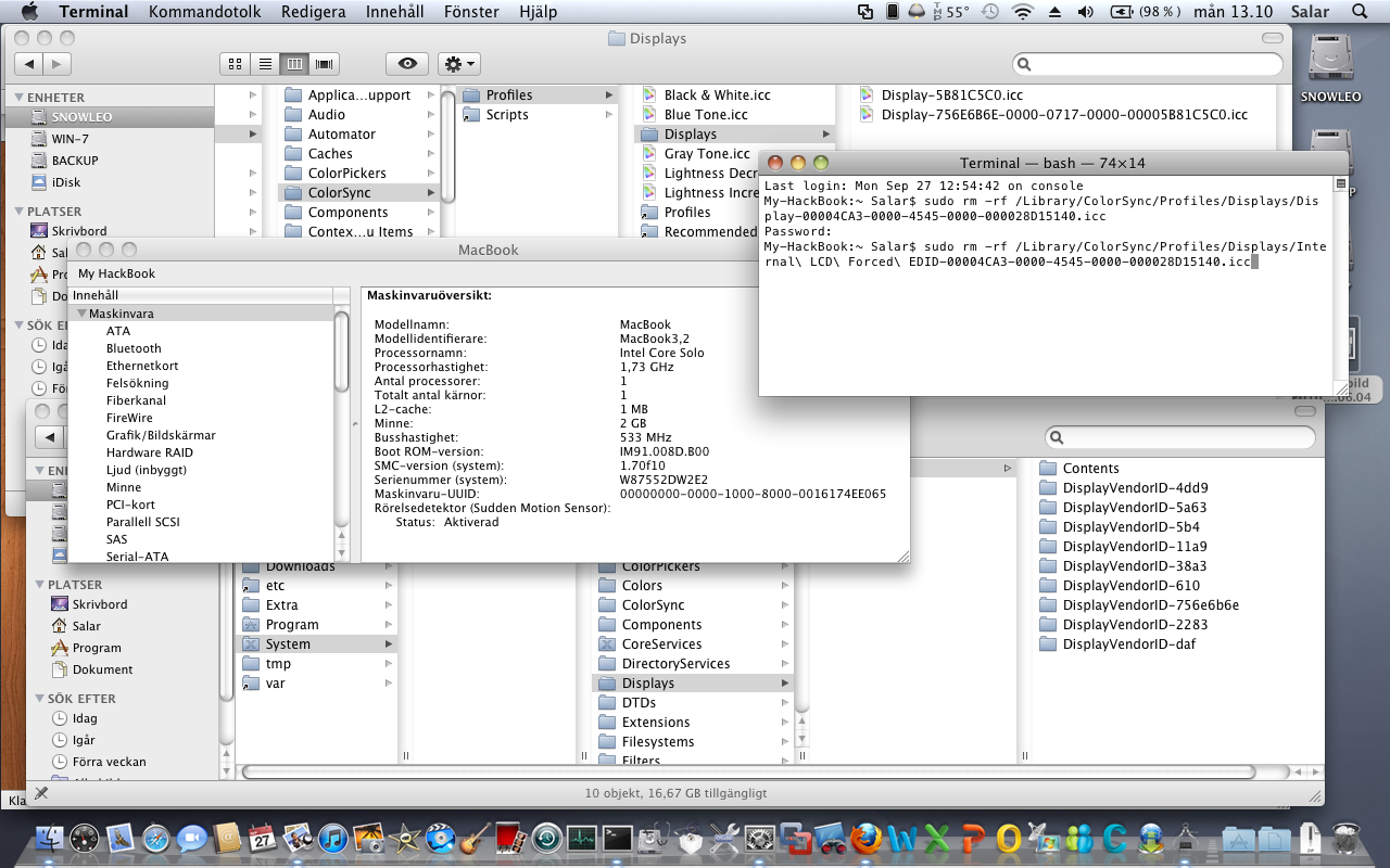

calmesal Posted September 25, 2010 Share Posted September 25, 2010 Worked here (the proofs are attached)... So, we did know in prior pages about that thread by CharredPC, but I think anybody in this current topic applied that fix. Now I can confirm that the display EDID override seems to be a excellent alternative to go. I followed the instructions, just I omitted the step 6 from the part A... and all looks as should be. Unfortunately I can't test if this can solve brightness problems, because my glossy lcd (backlight) works OOTB (w/o issues at all) since Leopard just with PNLF addition to DSDT. Nevertheless, I can say after applied the fix I got better quality of the image colors with the new profile created. Recommended. Good Luck. Note: Once applied the CharredPC solution for test (we need testers), would be interesting to know which part of dsdt injection (Method _DSM, 4) its still needed by GFX0 device? Or if any GFX dsdt patch is needed anymore? Just installed your EDID override and it worked until I go into Systemprefs Display and a popup tell me that the displaymode will change to 800x600 and then I cant change back unless I logout and login again. I tried to trash the display overide profile but I cant get rid of it. Please tell me how to do it. Thanks Link to comment Share on other sites More sharing options...
juanerson Posted September 25, 2010 Share Posted September 25, 2010 @calmesal, My friend please, tell me why you did that? So, my attachment files above are just for referential purposes... because the procedure by CharredPC should be applied for your specific lcd display... Then, you have read that thread? Because you would know that can damage your screen. To revert your actual situation, Open Terminal an type two lines: 1) sudo rm -rf /System/Library/Displays/Overrides/DisplayVendorID-4ca3 (press enter and your password -- enter) 2) sudo rm -rf /Library/ColorSync/Profiles/Displays/Internal\ LCD\ Forced\ EDID-00004CA3-0000-4545-0000-000028D15140.icc Repair permissions and restart. Link to comment Share on other sites More sharing options...
calmesal Posted September 26, 2010 Share Posted September 26, 2010 @calmesal, My friend please, tell me why you did that? So, my attachment files above are just for referential purposes... because the procedure by CharredPC should be applied for your specific lcd display... Then, you have read that thread? Because you would know that can damage your screen. To revert your actual situation, Open Terminal an type two lines: 1) sudo rm -rf /System/Library/Displays/Overrides/DisplayVendorID-4ca3 (press enter and your password -- enter) 2) sudo rm -rf /Library/ColorSync/Profiles/Displays/Internal\ LCD\ Forced\ EDID-00004CA3-0000-4545-0000-000028D15140.icc Repair permissions and restart. Dear Juanerson! I did your terminal command and checked that the profile is gone, but the problem still there. I aplied your profile thouth it givs me better display didnt know could be that difficult to get rid of it. Do you have any other suggestion? Link to comment Share on other sites More sharing options...
juanerson Posted September 26, 2010 Share Posted September 26, 2010 Have you re-checked if the entire override profile is gone? Was two commands, and of course for two different address: 1) /System/Library/Displays/Overrides/DisplayVendorID-4ca3 (this is a folder) 2) /Library/ColorSync/Profiles/Displays/Internal LCD Forced EDID-00004CA3-0000-4545-0000-000028D15140.icc (is a file) And repeat, you have read that CharredPC thread? Its not difficult to do the procedure. I can help you with your dump (ioreg terminal output) in text file. But first delete the actual profile, and boot with dsdt.aml for 6820s (have any graphic injection). Link to comment Share on other sites More sharing options...
calmesal Posted September 26, 2010 Share Posted September 26, 2010 Have you re-checked if the entire override profile is gone? Was two commands, and of course for two different address:1) /System/Library/Displays/Overrides/DisplayVendorID-4ca3 (this is a folder) 2) /Library/ColorSync/Profiles/Displays/Internal LCD Forced EDID-00004CA3-0000-4545-0000-000028D15140.icc (is a file) And repeat, you have read that CharredPC thread? Its not difficult to do the procedure. I can help you with your dump (ioreg terminal output) in text file. But first delete the actual profile, and boot with dsdt.aml for 6820s (have any graphic injection). Thanks for the quick reply, just checked twice that both the directory and the icc file is gone, upon the reboot the icc file coming back again. Could that be sonthing else? I will try the with the 6820s dsdt. My dsdt is from 6720s package and working 100%. Edit: Just tried the 6820s dsdt and it the same, I just dont get it! Must be som other stuff I have to remove. Link to comment Share on other sites More sharing options...
juanerson Posted September 26, 2010 Share Posted September 26, 2010 Thanks for the quick reply, just checked twice that both the directory and the icc file is gone, upon the reboot the icc file coming back again. Could that be sonthing else? I will try the with the 6820s dsdt. My dsdt is from 6720s package and working 100%. Edit: Just tried the 6820s dsdt and it the same, I just dont get it! Must be som other stuff I have to remove. I think its not possible that the .icc come back if the override folder do not exist, but can you upload screenshots of your display system preference (color panel)... and one capture from your "/Library/ColorSync/Profiles/Displays/" folder, but thats should be solve making and installing your own override profile (folder). I need your ioreg dump as said for try to help you. Link to comment Share on other sites More sharing options...
calmesal Posted September 26, 2010 Share Posted September 26, 2010 I think its not possible that the .icc come back if the override folder do not exist, but can you upload screenshots of your display system preference (color panel)... and one capture from your "/Library/ColorSync/Profiles/Displays/" folder, but thats should be solve making and installing your own override profile (folder). I need your ioreg dump as said for try to help you. Just to bere 100% sure I deleted the override folder and upon reboot the icc file is back again, I can post screenshots but I am sure this is not the problem, here is my ioreg anyway. My_HackBook.zip Link to comment Share on other sites More sharing options...
juanerson Posted September 26, 2010 Share Posted September 26, 2010 Just to bere 100% sure I deleted the override folder and upon reboot the icc file is back again, I can post screenshots but I am sure this is not the problem, here is my ioreg anyway. I am 1000% sure you are doing something wrong... Sorry but, after apply the two command (very important with sudo) lines from terminal, that "override folder" (first command line) would disappear forever... and same effect with the .icc file (the profile) after the second command line. Also, your IOReg not help to much because have my graphic EDID (my own display screen) loaded... you understand? Then, you have profile iMac9,1 (is not a laptop) loaded (from smbios.plist) and that is a very bad idea and totally inverse to simulate macbook profile, and please thinking about graphic (X3100) its unacceptable... So, you need macbook3,2 profile as we use for power management (explained for native speedstep for example)... and for better general behavior, you get the point? Please sorry, I want to help you, but first of all read the thread. Link to comment Share on other sites More sharing options...
Defender666 Posted September 27, 2010 Share Posted September 27, 2010 Do you have SwitchResX installed?? Would explain why the folder comes back. Try to follow the guide and inject proper EDID Info your display. Link to comment Share on other sites More sharing options...
calmesal Posted September 27, 2010 Share Posted September 27, 2010 I am 1000% sure you are doing something wrong... Sorry but, after apply the two command (very important with sudo) lines from terminal, that "override folder" (first command line) would disappear forever... and same effect with the .icc file (the profile) after the second command line. Also, your IOReg not help to much because have my graphic EDID (my own display screen) loaded... you understand? Then, you have profile iMac9,1 (is not a laptop) loaded (from smbios.plist) and that is a very bad idea and totally inverse to simulate macbook profile, and please thinking about graphic (X3100) its unacceptable... So, you need macbook3,2 profile as we use for power management (explained for native speedstep for example)... and for better general behavior, you get the point? Please sorry, I want to help you, but first of all read the thread. Thank you very much for your help, I know it is very difficult for you guys to help, you dont know what Iam doing. I tried to follow exact the instruction you gave me. Here is a screenshot. I am not using the switchresx. Link to comment Share on other sites More sharing options...
juanerson Posted September 27, 2010 Share Posted September 27, 2010 On capture my override profile is gone (In theory). Now, type this command for delete all profiles .icc to depurate his folder: sudo rm -rf /Library/ColorSync/Profiles/Displays/*.icc (press enter) --- (pass) --- (enter). Restart the system. Note: Has another way by deleting the files from windows with macdrive (win7 version in your case). Link to comment Share on other sites More sharing options...
