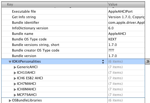

Activating Native AHCI with DSDT.
With DSDT we can "active" the AHCI without LegacyAppleAHCIPort.kext, and allow Snow Leopard compatibility.
The AppleAHCIPort.kext can support these AHCI:
Name: ACHI - IOPCIPrimaryMatch
ICH10			 0x3a228086
ICH6 ESB2		 0x26818086
ICH7-M			0x27c58086
ICH8-M			0x28298086
MCP79 (nVidia)	0x0ab910de
If we remove LegacyAppleAHCIPort.kext, we will get an "Generic AHCI" on System Profiler.
The 'trick' is force to Mac OS X identify your "device" changing the 'Device ID' with one in above list. Please select one of them.(more close to your chipset)

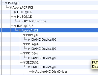

.:HOW TO USE DSDT:.
Open IORegistryExplorer and find AppleAHCI.
In my case, the device 'SAT0@1F,2' is related to the AppleAHCI.
We got:
SAT0 = Device
IF (001F), 2 (0002) = Address
So, we have the address: 0x001F0002.
.:HOW TO EDIT DSDT:.
Open dsdt.dsl or dsdt_fixed.txt with TextEditor.
Find for Device "SAT" or IDE1 (on some cases)
Probably we will get this:
Device (SAT0)
				Name (_ADR, 0x001F0002)
The Device name is not important, we must note is the Address.
Name (_ADR, 0x001F0002).
As we can see, the address is the same of IORegistryExplorer, everything is right!
We can now insert the code to change the "Device ID",
							Store (Package (0x02)
								   "device-id",
									   Buffer (0x04)
											  0xC5, 0x27, 0x00, 0x00
									   }, Local0)
					   Return (Local0)
Insert this below "Name (_ADR, 0x001F0002)"
Change the line: 0xC5, 0x27, 0x00, 0x00.
In this case(ICH7-M) the AHCI device ID is 27C5, but the code in DSDT is inverted. The "Device ID" on DSDT code should be reversed as in the example above.
.:Now all to do is (re)compile DSDT:.
Good luck.
Regards
Thiago.

Listet as :
IOACPIPlane:/_SB/PCI0@0/IDE1@1f0002
Does this (not listed in your list) mean its not recommended to do this with dsdt ?

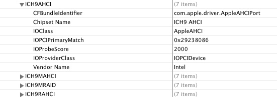

Would this work for JMicron as well? If so what would the device ID's be?
I done that dtm for my IHC9 (2923, 4 Port SATA, EP35-DS3)
But i leaved the AHCIPortinjector. Works. IOREGISTRY shows now SAT1 indest of IDE, but hatsjust cosmetic.
Why ?
Because some injection is needed (by that info.plist or DSDT) for values that the orig. AppleAHCI didnt have for some ICHx
It only has that from your list , not ICH9 nonraid, and also not some others (like the big list in the injector .plist)
In the next step i will inject also that stuff (like for DSDT GPU vs efistring/natit ) and report back.
Below the ICHx versions which OS X can handle without injectors , and second that was the AHCIPortinjector injects for others.
I dont know how to put those /and which entrys in an method.
Added:
Those kind of injectors like the AHCI are not really an problem, because their content is only an .plist.
No code content (like natot.kext or some others) which may be a problem for snow leopard.
That kind of .plist injectors (an .kext, but they have only an .plist in) work without any problem also with 64Bit Snow Leopard, because they have no code, only an .plist with data.
All other injectors which have also code (32Bit most) like natit and others like ATY_INIT, are sure really problematical for running snow leopard.
Why ?
Added:
I can't get my ICH9 to work using this method. Any suggestions?
		Device (IDE1)
						"device-id",
						Buffer (0x04)
