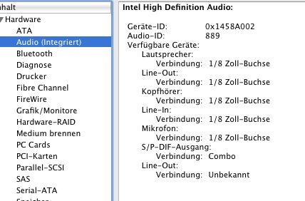

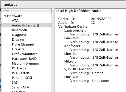

mitch_de Posted November 27, 2008 Share Posted November 27, 2008 Thanks roisoft. I can confirm that this dsdt (HDEF part) and AppleHDA.kext is working on my GA-EP45-DS4 m/b with F8 bios (didn't work on F9, for some reason). Same results as you apart from my windows are in English. thanks again!! AB dsdt_fixed_f8mod1.txt TO roisoft Hi, i have an GA-EP35-DS3(no ...P) Rev 2.1 BIOS F3 , which has also an 889a Chip. I used the dsdt changes and recompiled it - no errors - injection worked , which shows Systemprofiler screenshoot. I also removed my HDAEnabler.KEXT and used your (within the .zip) AppleHDA.kext. But the Audio Systempref shows no Audio Devive and i get some errors (using dmesg log). Sound assertion "0 == pathMap_aDriverInstance" failed in "/SourceCache/AppleHDA/AppleHDA-157.1.24/AppleHDA/AppleHDADriver.cpp" at line 1653 goto Exit Sound assertion "0 != createAudioEngines ( fPathMap_aDriverInstance )" failed in "/SourceCache/AppleHDA/AppleHDA-157.1.24/AppleHDA/AppleHDADriver.cpp" at line 108 goto Exit Sound assertion "0 == pathMap_aDriverInstance" failed in "/SourceCache/AppleHDA/AppleHDA-157.1.24/AppleHDA/AppleHDADriver.cpp" at line 1653 goto Exit Sound assertion "0 != createAudioEngines ( fPathMap_aDriverInstance )" failed in "/SourceCache/AppleHDA/AppleHDA-157.1.24/AppleHDA/AppleHDADriver.cpp" at line 108 goto Exit ??? Thanks EDIT: I GOT IT !!!!! THANKS for roisoft zipped GA-pack for 889A !!! to ALL I removed my old (forgot it ) ALCINJECT.KEXT also , not only the HDAENBLAER.KEXT Now all works. I add an new screenshoot (first is working dsdt HDA patching, but with ALCINJECT not deleted, second ALC... removed) So all HDA dsdt patchers should remove all other Sound Injectors (HDAENABLER + ALCINJECT) I uploaded my GA-EP35-DS3-REV2_1_F3 , roisofts APPLEHDA.KEXT (not changed by me) , dsdt.aml (ready with HDA), and Kext Install Helper (Tool to install .kexts for rights set OK!) GA_EP35_DS3_REV2_1_F3.zip Link to comment Share on other sites More sharing options...

mitch_de Posted November 27, 2008 Share Posted November 27, 2008 Thanks , I'll try tonight at home... Hi, ac3bcn, i dont know if i looked in your dsdt.txt also, but someone announces a HDEF dsdt part for GA-EP35-DS3P which has 885 Device in ?! and some other things different to the roisoft uploaded one!!! (I made an complete GA-EP35, BIOS F3, 889A package with chameleon dsdt in my last post). I would check if you perhaps use that - if you have also 899A, like me with GA-EP35-DS3 (without P)!! Thats what someone has uploaded as GA-EP35-DS3P , for my Board (889A, GA-EP35-DS3) it would be wrong - im am sure ! Conent of that uploaded (885?!) Device (HDEF) { ..... same ..... Method (_DSM, 4, NotSerialized) { Store (Package (0x08) { "codec-id", Buffer (0x04) { 0x85, 0x08, 0xec, 0x10 }, "layout-id", Buffer (0x04) { 0x0C, 0x00, 0x00, 0x00 }, "device-type", Buffer (0x011) { "ALC885" }, "PinConfigurations", Buffer (0x28) { /* 0000 */ 0x10, 0x40, 0x01, 0x01, 0x64, 0x10, 0x01, 0x01, /* 0008 */ 0x71, 0x60, 0x01, 0x01, 0x82, 0x20, 0x01, 0x01, /* 0010 */ 0x30, 0x90, 0xA1, 0x01, 0x20, 0x90, 0xA1, 0x02, /* 0018 */ 0x40, 0x30, 0x81, 0x01, 0x50, 0x40, 0x21, 0x02, /* 0020 */ 0xF0, 0x71, 0x44, 0x01, 0x90, 0x71, 0x45, 0x11 } }, Local0) DTGP (Arg0, Arg1, Arg2, Arg3, RefOf (Local0)) Return (Local0) } Method (DTGP, 5, NotSerialized) { If (LEqual (Arg0, Buffer (0x10) { /* 0000 */ 0xC6, 0xB7, 0xB5, 0xA0, 0x18, 0x13, 0x1C, 0x44, /* 0008 */ 0xB0, 0xC9, 0xFE, 0x69, 0x5E, 0xAF, 0x94, 0x9B })) { ....same ... } Link to comment Share on other sites More sharing options...
