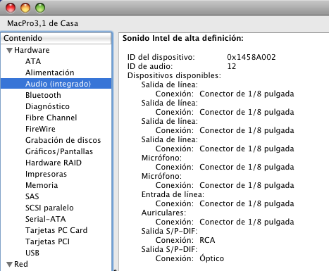

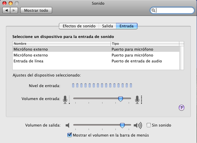

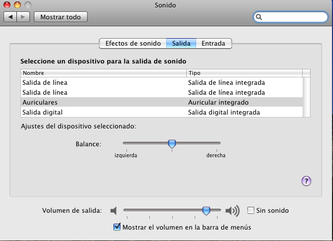

Hi Everybody, here is the code for DSDT to correct showns HDA In/Out for ALC889a on GA-EP35-DS3P, in System Profiler.
Device (HDEF)
			Name (_ADR, 0x001B0000)
					Return (Package (0x02)
						0x0D,
						0x05
				Store (Package (0x08)
						"codec-id",
						Buffer (0x04)
							0x85, 0x08, 0xec, 0x10
						"layout-id",
						Buffer (0x04)
							0x0C, 0x00, 0x00, 0x00
						"device-type",
						Buffer (0x011)
							"ALC885"
						"PinConfigurations",
						Buffer (0x28)
							 /* 0000 */   0x10, 0x40, 0x01, 0x01, 0x64, 0x10, 0x01, 0x01,
							 /* 0008 */   0x71, 0x60, 0x01, 0x01, 0x82, 0x20, 0x01, 0x01,
							 /* 0010 */   0x30, 0x90, 0xA1, 0x01, 0x20, 0x90, 0xA1, 0x02,
							 /* 0018 */   0x40, 0x30, 0x81, 0x01, 0x50, 0x40, 0x21, 0x02,
							 /* 0020 */   0xF0, 0x71, 0x44, 0x01, 0x90, 0x71, 0x45, 0x11
					}, Local0)
				Return (Local0)
			Method (DTGP, 5, NotSerialized)
			    If (LEqual (Arg0, Buffer (0x10)
			                    /* 0000 */    0xC6, 0xB7, 0xB5, 0xA0, 0x18, 0x13, 0x1C, 0x44,
			                    /* 0008 */    0xB0, 0xC9, 0xFE, 0x69, 0x5E, 0xAF, 0x94, 0x9B
			            If (LEqual (Arg1, One))
			                If (LEqual (Arg2, Zero))
			                    Store (Buffer (One)
			                            0x03
			                        }, Arg4)
			                    Return (One)
			                If (LEqual (Arg2, One))
			                    Return (One)
			        Store (Buffer (One)
			                0x00
			            }, Arg4)
			        Return (Zero)
That´s not mean everytihing is working.
Headphones OUT and Line Out Rear Stereo(Green) are working, I can not get working the other 3 Analog lines Out Central/Lfe, Surround and Sides.
Line In and Mics Not tested yet.
This is the Codec Verb for HDAController

I Began working with Linux Dump Codec(Mandriva 2009 Live CD), then I correct with information from Reltek ALC889a Technical Datasheet and then i've updated with the results for DSDT PinConfigurations.
Add Text file with Codecs Verbs Evolution for ALC889A - GA EP35-dS3P
CODEC_Verbs_ALC889A.rtf
