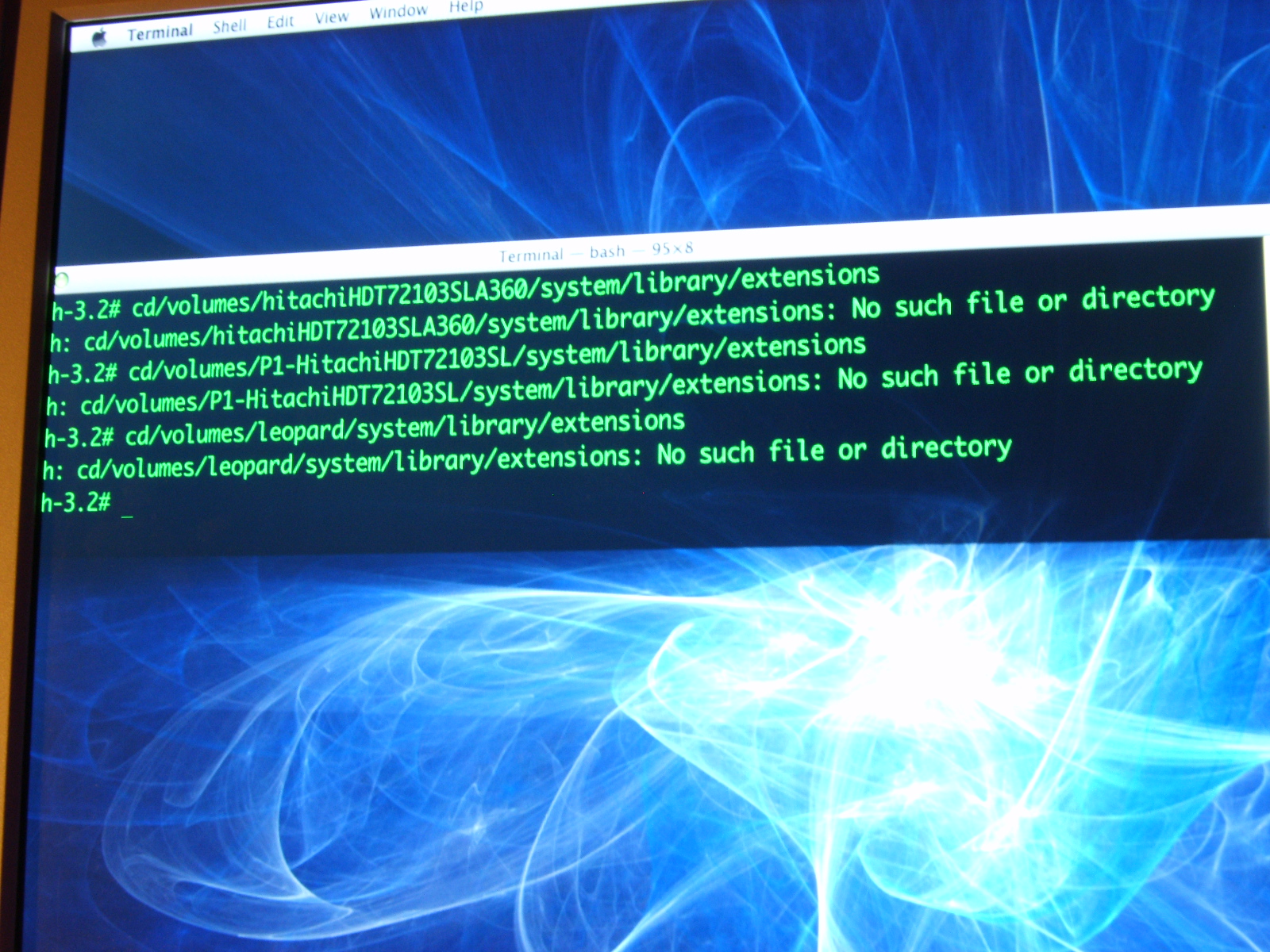

Im having some difficulty at the moment Verdant. im getting the reply 'no such file or directory'
ive tried a few different variations of HDD name:
(how it appears in Disk Utility) 'hitachiHDT72103SLA360'
(how it appear on my BIOS) 'P1-HitachiHDT72103SL'
(the name of the partiton on the HDD) 'Leopard'

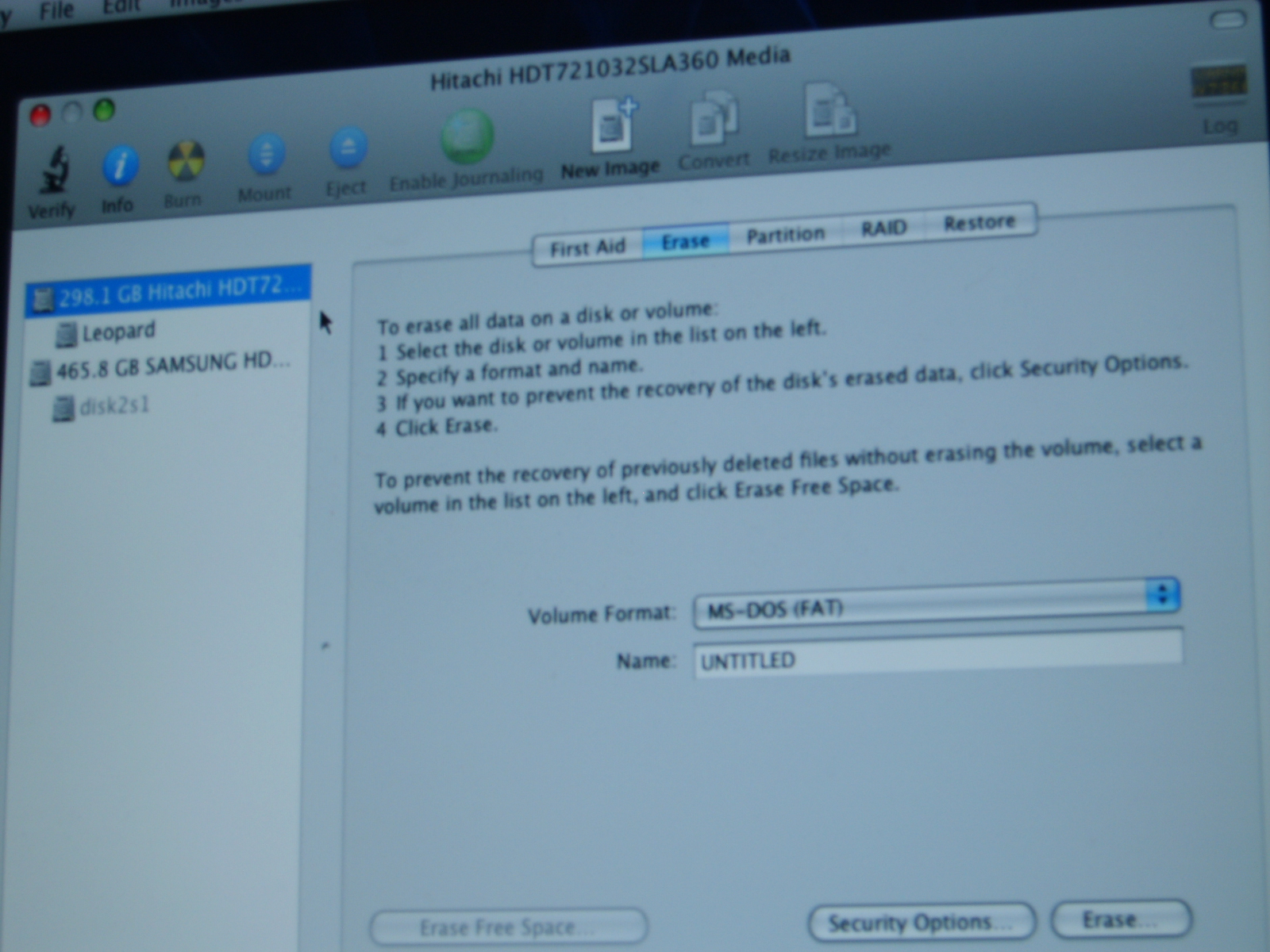

Screenshot :
The 'leopard' partiton on the HDD is in 'Mac OS Extended (Journaled)' format,
however i have just noticed that the HDD as a whole is in MS-DOS Format. Would this make a difference?
I have attached a screenshot to show you what i mean.

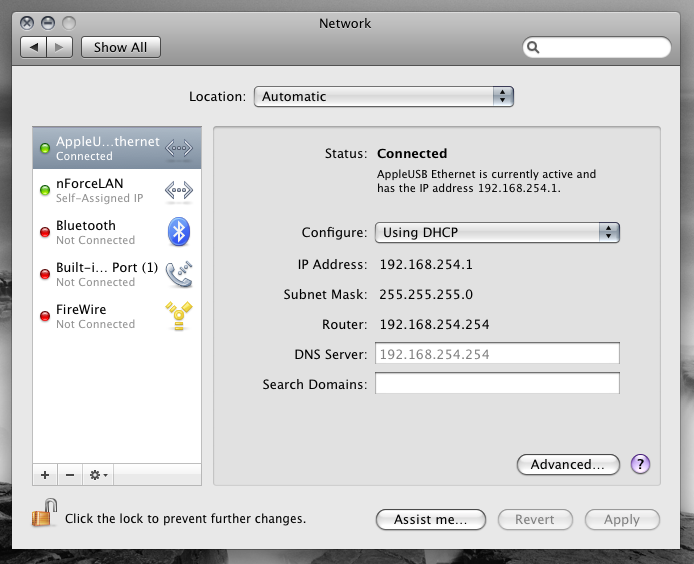

Hi mate.
My system specs is very detailed so I can encourage people to try.
nForceLAN.kext for me worked like a charm. In my system I use an AppleUSBEthernet Adapter, but I can show you that my onboard LAN works perfectly too.
About the BIOS, this one I´m using now from OMN´s solved all my issues. I bothered verdant a lot with a freezing problem that could only be solved when he suggested me to use a different BIOS from OriginalMACNUT. Flashing a BIOS is not complicated but requires some care. A bad bios flash can cause you a lot of trouble. I already posted here in the forum how to flash the MSI BIOS with it´s own flash utility.
Unfortunately I can´t garantee you that your process will be succefull. But I can assure you that the process is pretty easy and fast. If you put your computer into a no-break to assure that you won´t have power loss, I believe you won´t have problems.
Screenshot :
Since from the screenshot it appears that you want to install OS X on its own hard drive with 298GB to use, I recommend for general PC use (i.e. rather than as a server) that you partition the hard drive as Master Boot Record (MBR) via the Partition menu tab in OS X Disk Utility and format it as Mac OS Extended (Journaled) volumes, into a minimum of 4 volumes (depending on your HDD capacity) as follows:
1st volume at the start of HDD is a small 10GB volume (choose a name without spaces e.g. Leopard_Boot or OS_X_Boot etc) that to use as a OS X boot volume with ONLY a basic fully working OS X install from your chosen OS X Install DVD (which enables you to use its Disk Utility functions on the other OS X volumes), together with:
Kext Helper b7
OSx86Tools
PC EFI v9 Chameleon Bootloader Installer
and any other Utiliy software you find very useful for OS X system installation/maintenace/repair etc., to enable you to modify/test OS X updates on the Main and Backup OS X volumes without ever risking not being able to boot into OS X on this HDD.......
The 2nd and 3rd volumes are equal size volumes each, which for use OS X Main and Backup (or Test) systems respectively.......suggest you use a size of at least 40GB for each.....
The 4th volume is a OS X Data Archive volume with all your archived OS X and OS x86 software, documents files, image files, music files, or whatever you wish to archive and keep safe......
