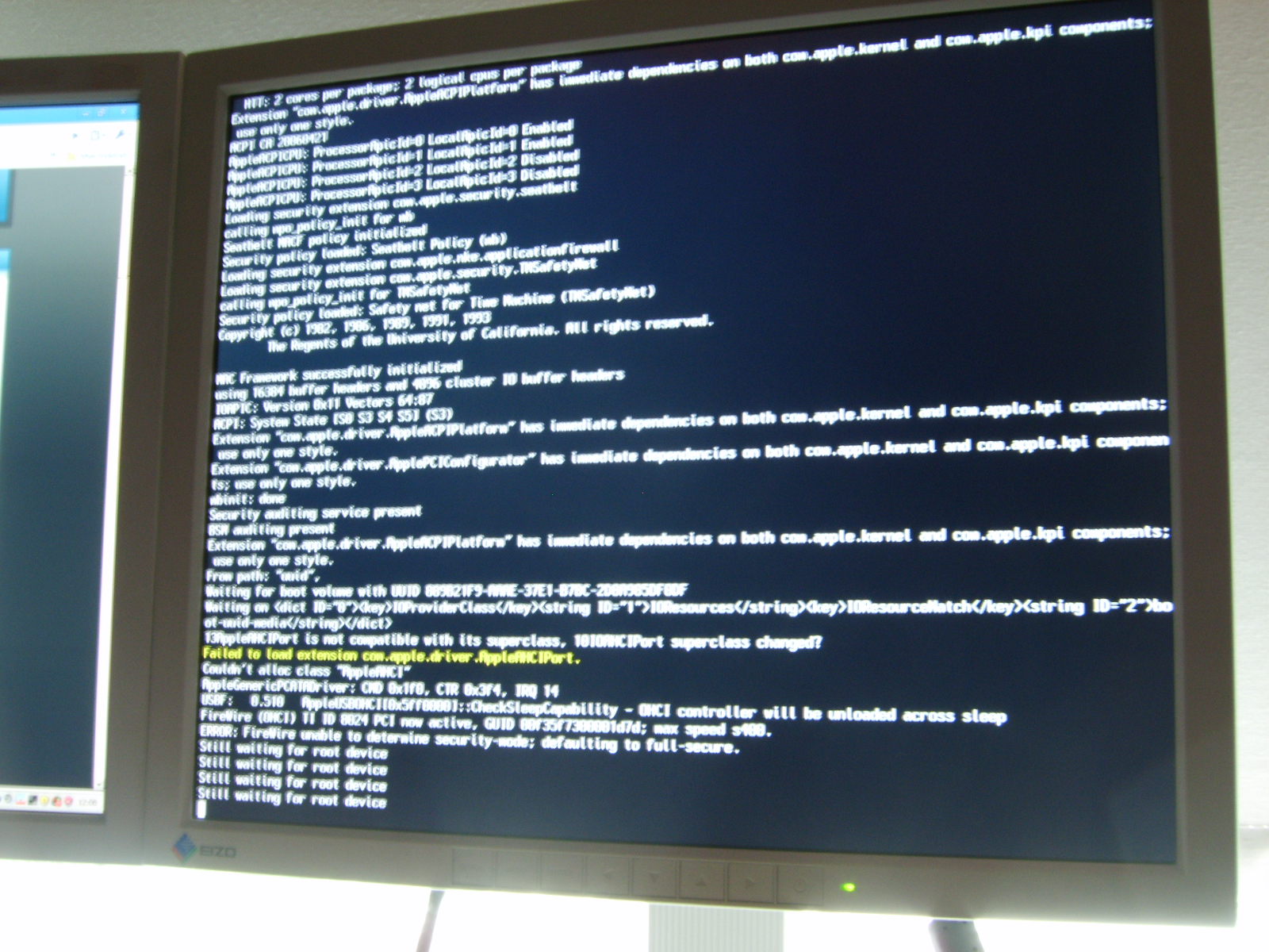

My DVD is pata and connected to a cable with only 1 connector and jumpered master. Booting the iDeneb 1.4 dvd and installing works like a charm.
The issue I seem to have after install finished is a firewire issue.
@ bozotheclown - are you having any USB device (e.g. memory stick) mounting issues after bootup......ensure that you have the same kernel and System.kext versions.......see here.......
No post in #588.....? BTW breakingbad has requested a modded BIOS from OriginalMACNUT for you.....
The problem seems to be with the AppleAHCIPort.kext......
AFIK the mach_kernel should not be trying to load the AppleAHCIPort.kext but rather the AppleNForceATA.kext since you have an nForce chipset MOBO......
What distro installed OS X system are you currently trying to boot from on your HDD?.......what kernel did you choose in the Customize menu......, and what chipset did you choose in the Customize menu......you need only choose nForceATA.....

Please always boot with -v so that I get more detail on the errors on booting......are you still getting the "failed to load extension com.apple.driver.AppleAHCIPort" and "Still waiting for root device" errors......?
Please try with
Kernel 9.2.0. ToH Y
Kernel 9.2.0 nForce Core EFI N
Please try with
Kernel 9.2.0. ToH Y
OK, installed the Kernal 9.2.0. ToH and still getting 'failed to load extension com.apple.driver.AppleAHCIPort' and also 'Still waiting for root device'
I am thinking about what to do.........
Boot from a working OS X Install DVD and go to Terminal in Disk Utility.
In Terminal type what is in quotes (minus quotes) and press Enter after each line
"cd /Volumes/Enter your HDD Name here/System/Library/Extensions"
"ls"
ls will list the files in the Extensions directory.......
Let me know if AppleAHCIPort.kext is present......
If it is then in Terminal type what is in quotes (minus quotes) and press Enter after each line
"sudo mv AppleAHCIPort.kext AppleAHCIPort.kext.orig"
mv renames AppleAHCIPort.kext to AppleAHCIPort.kext.orig
"exit"
exit closes the Terminal session
Exit Disk Utility, Click Restart button in DVD Installer menu........the system should start booting from the HDD.....
