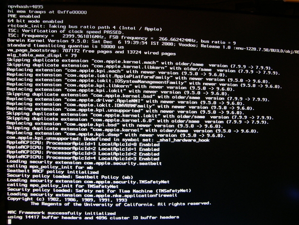

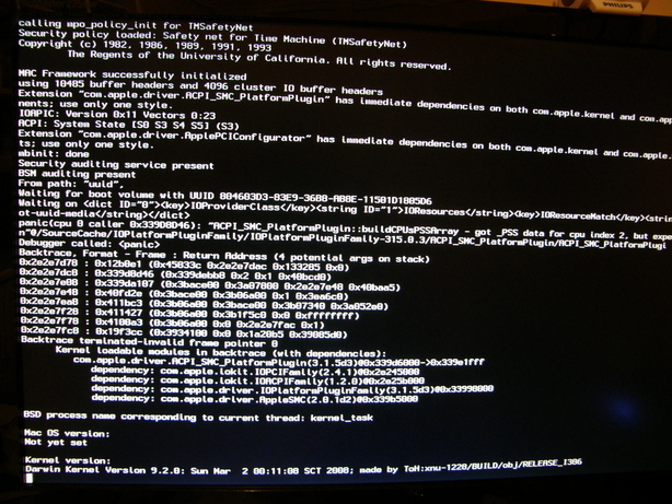

Hi,
has anyone installed with a MPC73 chipset?
I have tried Kalyway 10.5.2 and iDeneb 10.5.5 and impossible.
I changed the hard drive and unplugged the another I have, so I'm trying to a new sata hdd completely new, but I haven't had any sucessful intallation.
Your previously mentioned error
"using 14417 buffer headers and 4096 cluster IO buffer headers"
is likely BIOS related since "buffer headers and cluster IO buffer headers" in boot up error messages invariably point to BIOS issues......as does only being able to boot with cpus=1......see post #1 for section on BIOS DSDT modding.......
You need to let me know what BIOS options you have and do not have, compared with my recommended OSx86 settings for 610i in post #1, how much MOBO RAM you have (is it 3GB?) and be more specific about your problems and what you get when booting any Install DVD with "-v cpus=1 maxmem=2048 debug=0x100" without quotes at the Darwin boot: prompt obtained on pressing F8.......
I recommend trying Mysticus C*'s 10.5.5 Combo Update packages like this:
1. Boot with -v cpus=1 maxmem=2048
2. Run nForce Drivers Package v1.2 with following choices nForceATA by slashack and usb fixes/usb mount fix/voodoo beta 2c kernel
3. Restart
4. Run nForce Pre-patch (with Installer logging on) and don't close installer window or restart
5. Run Combo Updater (with Installer logging on) and don't close installer window or restart
6. Run post-patch, choosing NVdarwin GFX Drivers/NVdarwin XXXMB and Patched NVDIA Drivers options...as well as your other selections......using Just Restore for Audio, Lan, etc.
You can then run Voodoo RV v1.0 Rev_A .dmg to install Voodoo RV v1.0 Rev_A kernel....
Aight so i followed this as much as i could along with Mysticus C's actual guide. I am unsuccessful... Alot further than last time as the Mac seems to "boot up" but i just get a black screen after the apple goes away and theres a FROZEN mouse cursor in the top right ALONG WITH my mouse cursor that i can move around. So i dunno what the hell happened but eh its weird. So i am on Kalyway 10.5.2 again. I am gonna try to run the update again from here but first im goin to burn iPC 10.5.6 so i can try to install that after this try (if this doesnt work) If you guys have any info on what the hell happened to me it would be greatly Apprecited! Ill link a picture of the screen in a few minutes.

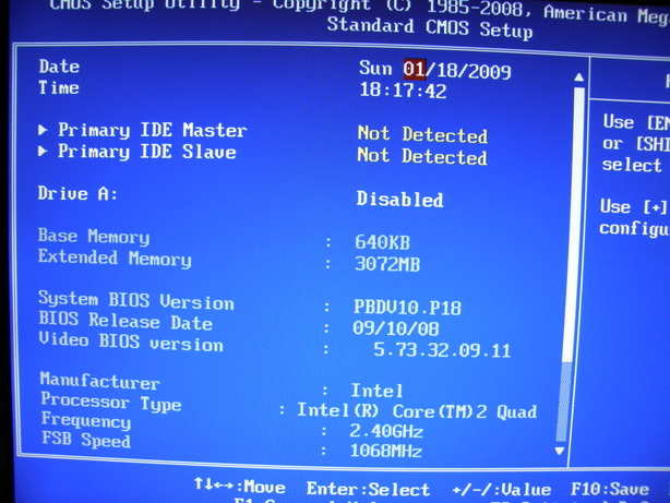

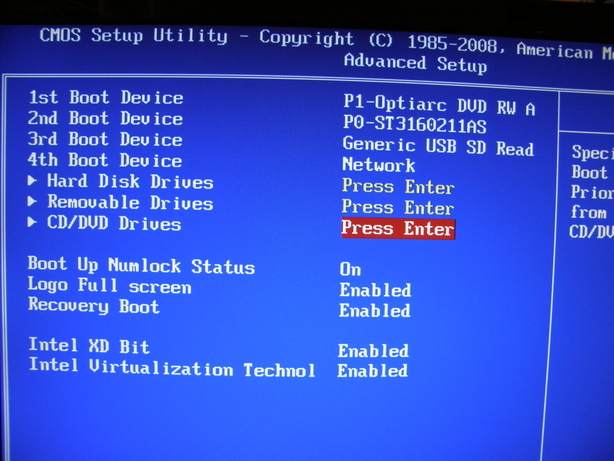

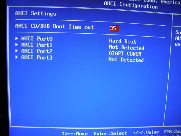

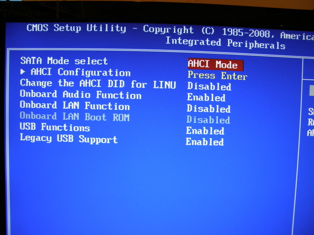

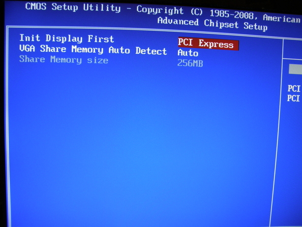

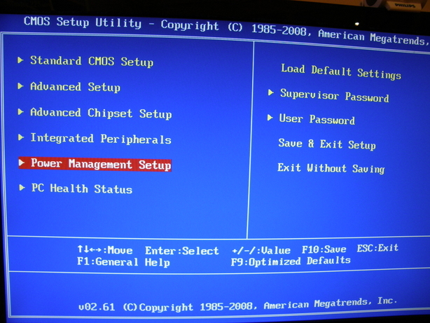

Hi, verdant thanks for the answer.
When I wrote the message about headers I had been trying to install iPC OSx86 10.5.6 with the three patches they have released (I forgot to write the name in the DVD). I have tried with the text you told me (-v maxmem=2048 debu=0x100) and the result is the same.
Anyway, with iDeneb 10.5.5 I had the same problem, but at least I could install. The problem was after the installation, when the computer is rebooted I had the same error message. I install with any flag, with one kernel, after the next one, ....
After your post I tried to install Kalyway with the same results, but in this case the message is different:
Darwin Kernel Version 9.2.0 Sun Mar 2 00:11:08 SCT 2008; made by Toh:xnu-1228/BUILD/obj/RELEASE_I386
and the DVD freezes.
The only distro I can find where I can choose kernel or patches is iDeneb.
So, I have taken pictures of the two erros and my BIOS. It's allways the same in all the installation I have tried until now.
All the specs of my computer are in the signature but I'm trying with another different SATA HDD (Seagate 7200.9, 160GB) and I have unplugged the another (with Linux and Vista) to avoid problems. If any installation is sucessful I will plug the another.
Best regards and thanks

Disabled 2nd interface in BIOS
Booted OSX, new interface appeared in network prefs, got DHCP, set to static, confirmed connection to the internet.
