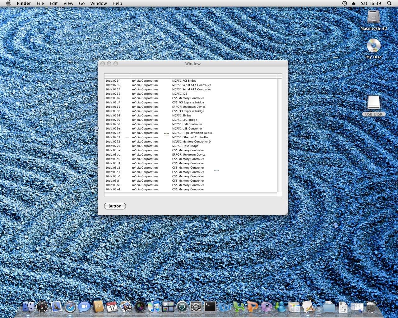

Boot with -v -x and run DPCIManager and post ouput here for me.....we can then sort things out hopefully......

And here you got a picture from DPCI manager, my USrobotics card wasn't plugged in btw
