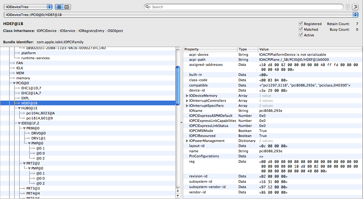

So i have tried this without success. Hereis my method. I have a SHuttle SP35P2V2. It has the ALC888B chipset. My generated DSDT did not have a HDEF entry, it had a very short AZAL entry. So I replaced the AZAL entry with cpram's HDEF I renamed AZAL to HDEF so I no longer have the AZAL entry in my DSDT. I found another difference in our dstd_fixed.txt, he had an entry:
Notify (\_SB.PCI0.HDEF, 0x02)
under
Method (_L0D, 0, NotSerialized)
so I added that since I had no such entry under my Method (_L0D, 0, NotSerialized) in my dsdt.
then I compile: /iasl -ta dsdt_fixed.txt
and install using UInstaller.
I also installed cprams patched AppleHDA.kext and have my audio card EFI string enabled via the other thread at http://forum.netkas.org/index.php/topic,104.0.html

My IORegExploer output is attached, as is my dsdt_fixed.txt. Any help?
