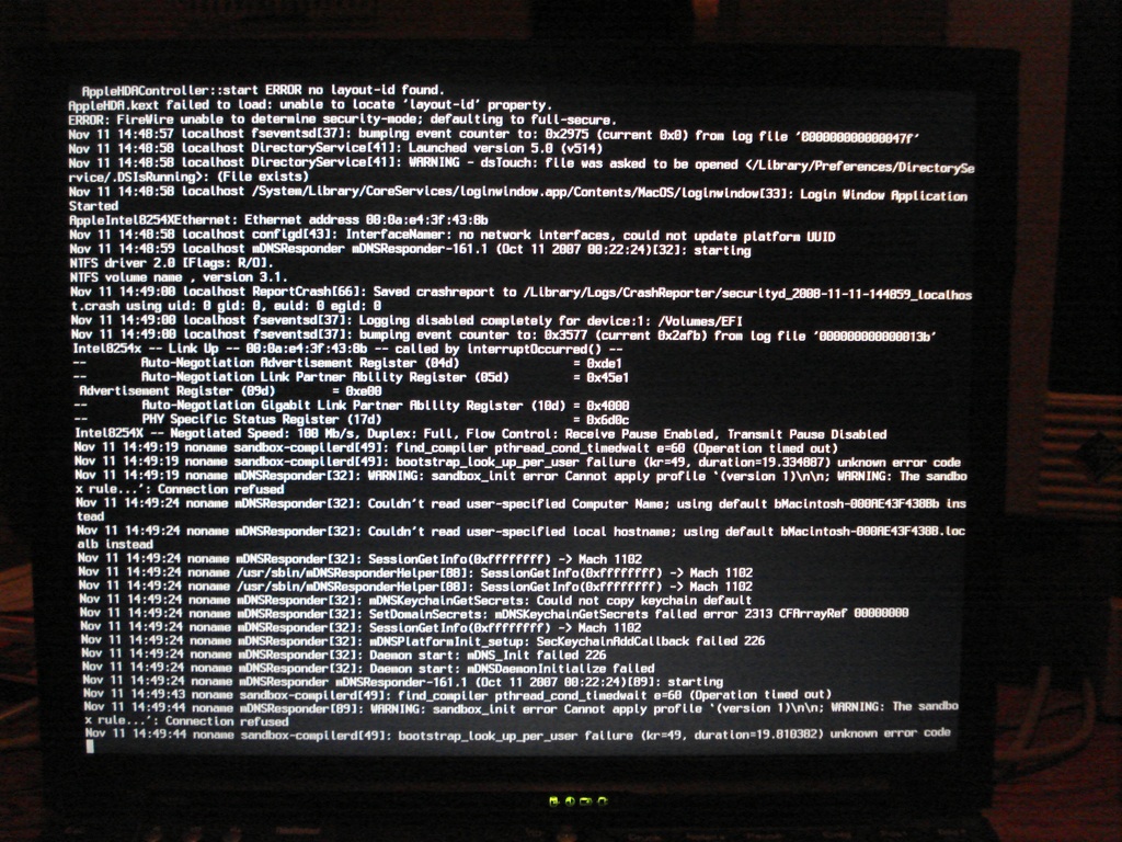

rxmd Posted November 12, 2008 Share Posted November 12, 2008 I am currently experimenting with this install method and am getting a slew of mDNS-related errors when booting the newly-installed, clean, virgin retail Leopard partition for the first time (see the attached image). Basically it seems that there is a networking issue won't go away. Has anyone ever seen these mDNS-related errors? My first idea was that this is an extension-related problem, but I get it even when booting without any extensions in the boot/"EFI" partition, so by now I'm doubting it a little bit. Currently the Extensions folder on the boot partition contains the following: AppleAHCIPort (for ICH7 AHCI); AppleIntelGMA950, AppleIntelIntegratedFramebuffer (modified to fit the PCI IDs) Natit IOGraphicsFamily, IONDRVSupport (original Leopard, only with OSBundleRequired set to Root to satisfy dependencies) dsmos, IntelCPUPMDisabler The system is a Thinkpad X60s, which has a 945 chipset, 950 graphics, a Core Duo processor and an 82577 LAN chipset; the latter is supported by OS X's 8254x driver (I'm currently posting through it on an iDeneb installation). Link to comment Share on other sites More sharing options...
nintendoguy Posted November 12, 2008 Share Posted November 12, 2008 ibeaspecalboy I did not know how to make a script select a certain partition to install. thanks for working that out and giving me credit EDIT: for the part where is says do a manual install, you could put my scripts in to solve that snag. 1 more thing: if you make a new thread in the genius bar, you will get a lot more views then at the end of a 35 page thread. i will make a link in my thread to your post until you do. Link to comment Share on other sites More sharing options...
