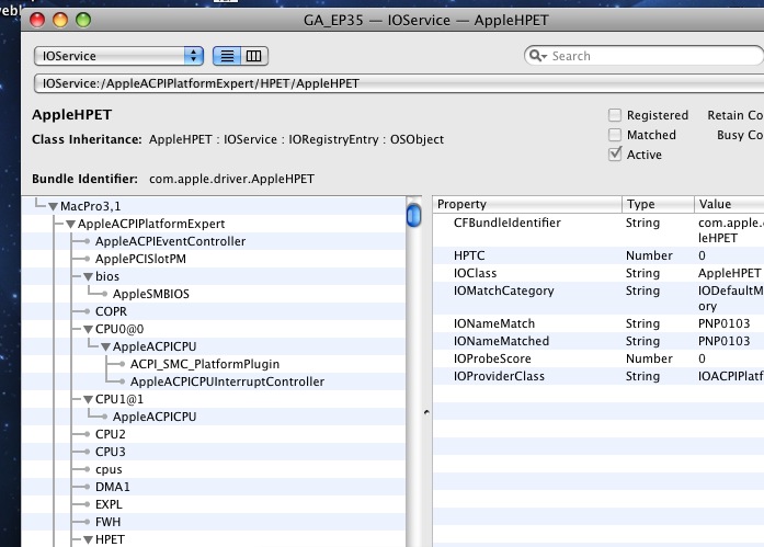

Q: I have AppleHPET kext in /Extensions but see no HPET in kextstat list.
Is HPET an driver which stays loaded or (some do so) is loaded when its needed / only at startup (and unloads then) ?
I can see (in the HPET .plist) that IOMATCHName = PNP0103.
Can it be that i dont have that PNP0103 device ? Or why is HPET not loaded ?
Or does my DSDT patched system removes HPET device ?
I now tried to kextload manualy:
Now shown with kextstat (last in list) :
92 0 0x5ab4c000 0x3000 0x2000 com.apple.driver.AppleHPET (1.3)
Very ??? why i can load this manually but was not loaded by system at startup.
But if i dont need that (no AppleIntelCPU... used), it doesnt matter.

Hi, we are on the way (getting HPET back) ;)
I solved my problem of lost HPET device + therefore not loading AppleHPET.kext.
I used before the DSDT Patcher GUI without option NEW HPET, now with that.
Now i can see (with terminal command kextstat) that AppleHPET is loaded by the system (not only manually).
I also, and that will be the reason why before not loaded, the device HPET is now listed (again , as weaks before).
The AppleIntelCPU..kext i removed from the /System/Extensions, not needed like AppleHPET i think.

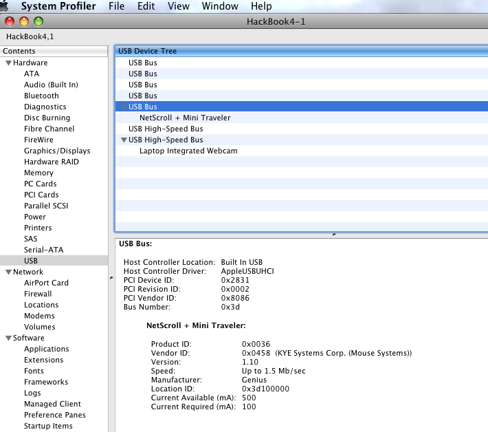

Slice don't know if it is due to your driver or not but since I installed your driver I can wake up my computer from sleep by clicking on the mouse or keyboard (usb)
Only one thing that has to be noticed
when the mouse is plugged directly to the computer, I'm unable to use anymore after sleep (have to re-plug to get it work)
when the mouse is plugged on the MAC keyboard, I'm able to use it right after sleep ... (don't know why ?)
Cheers
Cheers
Please, look into system profiler in these two cases. May be you will see the answer.
You are very noob to do such tests.
