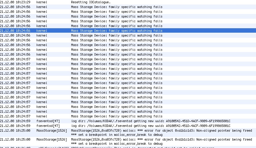

mitch_de Posted December 20, 2008 Share Posted December 20, 2008 Seems that the USBxxx.kext worked for me (as i told in before post). But the new IOUSBMASS.. maked trouble, i went back to orig. 10.5.6. 1. One of my USB Stick isnt seen, i get lots of errors in the konsole : Same Stick with orig. IOMASS : no problems 2. An second stick is seen but makes troubles in usage (also some konsole messages) Link to comment Share on other sites More sharing options...

Slice Posted December 21, 2008 Author Share Posted December 21, 2008 Yes your IOMASS V10.5.6 worked, but on one USB Stick the mount fails . I now use orig. IOMass (works) with all of your new USB... and IOPCI.. kext. Q: I see some kernel (i use vanilla) logs after plugin the uSB Stick ? What does that matching fails mean ? It may means of bad power supply of the stick. It may be a mistake of USB-driver. What is your chipset? Link to comment Share on other sites More sharing options...

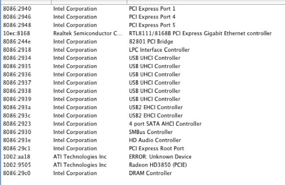

mitch_de Posted December 21, 2008 Share Posted December 21, 2008 It may means of bad power supply of the stick. It may be a mistake of USB-driver. What is your chipset? Its an small USB-Stick 4 GB (flash), no power supply. I have an GA-EP35-DS3, uses IHC9 (non Raid), but iam not sure. Added PCIManager (small OSX tool) Screenshoot showing dev IDs and my .ioreg (zipped) for IORegistryexplorer. GA_EP35_2.ioreg.zip Link to comment Share on other sites More sharing options...

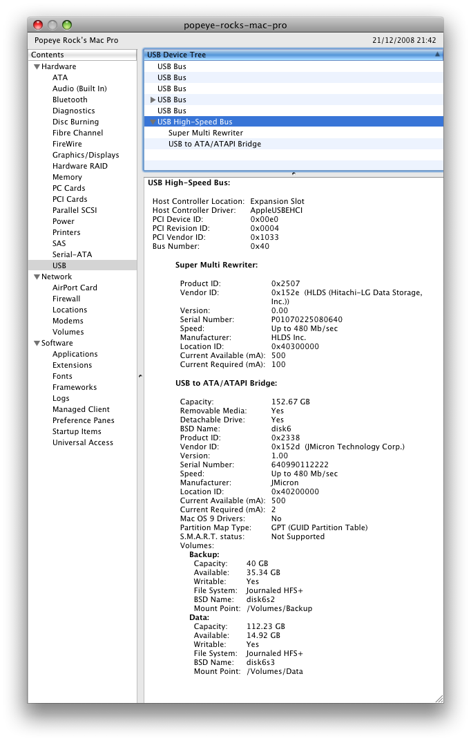

popeyeq Posted December 21, 2008 Share Posted December 21, 2008 Hi, I'm trying to get my MoBo USB 2.0 ports working properly. Since I update to 10.5.6, ports on MoBo working only like USB 1.1. My PCI USB 2.0 HUB working perfect. I used kext's from post 1. and nothing changed. This is part of my system.log [/b][/size][/size][size=2] Dec 21 20:18:47 localhost kernel[0]: Extension "com.apple.driver.AppleACPIPlatform" has immediate dependencies on both com.apple.kernel and com.apple.kpi components; use only one style. Dec 21 20:18:47 localhost kernel[0]: USBF: 0.708 AppleUSBEHCI[0x387b800]: unable to get filterInterruptEventSource Dec 21 20:18:47 localhost kernel[0]: USBF: 0.715 AppleUSBEHCI[0x387b800]::UIMInitialize - Error occurred (0xe00002be) Dec 21 20:18:47 localhost kernel[0]: USBF: 0.724 AppleUSBEHCI: unable to initialize UIM Dec 21 20:18:47 localhost DirectoryService[11]: _CFGetHostUUIDString: unable to determine UUID for host. Error: 35 Dec 21 20:18:47 localhost kernel[0]: Got boot device = IOService:/AppleACPIPlatformExpert/PCI0@0/AppleACPIPCI/IDE1@1F,2/AppleIntelPIIXATARoot/CHN0@0/AppleIntelICHxSATA/ATADeviceNub@0/AppleATADiskDriver/IOATABlockStorageDevice/IOBlockStorageDriver/MAXTOR STM3160215AS MAXTOR STM3160215AS/IOGUIDPartitionScheme/Untitled@2USBF: 1. 13 AppleUSBOHCI[0x385c000]::CheckSleepCapability - controller will be unloaded across sleep Dec 21 20:18:47 localhost configd[14]: _CFGetHostUUIDString: unable to determine UUID for host. Error: 35 Dec 21 20:18:47 localhost kernel[0]: BSD root: disk4s2, major 14, minor 17 Dec 21 20:18:47 localhost kernel[0]: USBF: 1. 94 AppleUSBOHCI[0x3984000]::CheckSleepCapability - controller will be unloaded across sleepUSBF: 1. 94 AppleUSBOHCI[0x3982000]::CheckSleepCapability - controller will be unloaded across sleep Dec 21 20:18:47 localhost kernel[0]: Extension "com.apple.driver.iTunesPhoneDriver" has no explicit kernel dependency; using version 6.0. Dec 21 20:18:47 localhost kernel[0]: AppleIntelCPUPowerManagement: initialization complete Dec 21 20:18:47 localhost mDNSResponder mDNSResponder-176.3 (Sep 30 2008 16:59:38)[16]: starting Dec 21 20:18:47 localhost kernel[0]: USBF: 6. 47 AppleUSBUHCI: unable to initialize UIM [b] Have you got any idea what could be wrong? Thank You Link to comment Share on other sites More sharing options...

popeyeq Posted December 24, 2008 Share Posted December 24, 2008 New idea! Try to delete/disable AppleHPET and AppleIntelCPUPowermanagement. AFAIK it conflicts with some devices: LAN, WiFi, so may be with USB2. Hi Slice, deleting AppleHPET and AppleIntelCPUPowermanagement kexts help out. no errors, all USB working. But no HPET. I hope there is way to fix this. Link to comment Share on other sites More sharing options...
