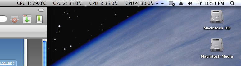

To those who would like to monitor your CPU temps within OSX in which all other methods fail e.g istat etc
I stumbled across this thread: http://forums.macrumors.com/showthread.php?p=6104252 post #567
Some people including myself have had sucess installing a free app called "Temperature Monitor" and then using a terminal command line crack to enable support for additional Intel CPU's
Here's what I did...
Download "Temperature Monitor" its free.
During installation if you use Intel CPU it will ask to install extra diagnostic apps - say yes to all.
Now close "Temperature Monitor" as It probably wont recognize your CPU yet, only your hard drives will show.
Do the terminal line crack "defaults write com.bresink.system.tempmonitor EnableCoreTempReadingsForCPU10670 1" without the "
Re-open "Temperature Monitor"
It will "now" recognize your Intel CPU
It will take a while to figure out how to get it to show your temps on your menu bar etc but just keep playing around and you'll get it.
So anyway it worked for my GA-EP45-DS3P and a Intel Q9550 Quad 2.83
Cheers
(Yes I realize my cores are not even... I may need to redo the thermal grease)

Great Success on the Audio front
I can confirm the same audio fix also works for the GA-EP45-DS3P Board!
I swear the audio quality is also better :P
Also an unexpected side effect is now my QE is activated as soon as Leopard starts.
Normally it would wait until I open an application (upon reboot)
I can tell because the top Menu bar goes semi transparent when QE is enabled.
I cant really explain it but anyway my Hackintosh is 100% working now
Sleep, Restart, Shutdown, QE, CI, Sound, Firewire, LAN and even Temperature monitoring of my quad CPU.
I can now sell my Macbook Pro
