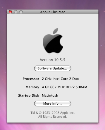

DJCrunkMix Posted September 22, 2008 Share Posted September 22, 2008 hi fellas, I just got everything to work - 100% perfect hackintosh. I thank weaksauce for his dedication towards this forum and this thread. Thanks man! I had small problems which I will post later along with my system specs! - Neil Link to comment Share on other sites More sharing options...

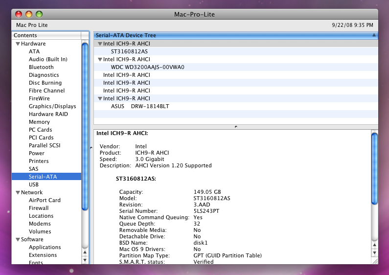

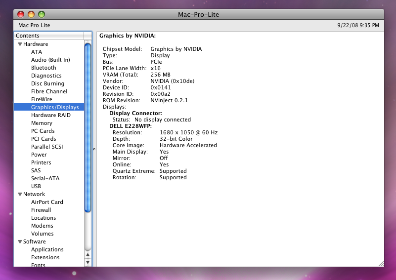

DJCrunkMix Posted September 22, 2008 Share Posted September 22, 2008 Hi guys, I got a 100% stable OSX working! I am going list down a few things that I think would be useful for others. My specs: 1) Intel E8400 @ Stock Clocks (Will OC it and post the benchmarks!) 2) Gigabyte GA-P35-DS3L Rev 2.0 mobo with F7 Bios 3) Samsung SATA DVD+-RW Drive 4) Seagate 500 GB 7200 RPM SATA Harddisk 4) Western Digital 300 GB 7200 RPM SATA Hardisk 5) EVGA 8800GT 512 MB Graphics Card 6) EMU 1616 PCI A/D Converter Audio Card 7) Dell E248WFP 24" monitor Problems faced: 1) My PS/2 Keyboard did not work, I used this link to download the PS2Fix1024 setup file before rebooting after 10.5.4 Delta upgrade: http://forum.insanelymac.com/index.php?showtopic=117359 2) After installing the following kexts: AppleSMBIOS.kext (System driver, updated for Memory) AppleAHCIPort.kext (SATA driver #1 of 2) IOAHCIFamily.kext (SATA driver #2 of 2) IOBluetoothFamily.kext (Bluetooth driver #1 of 2) IOBluetoothHIDDriver.kext (Bluetooth driver #2 of 2) I couldn't get past the Apple Logo. It got stuck there showing the "O" symbol with a "\" through it. I figured the problem was due to the face that its not reading the correct drive! For some reason, it was fixed by changing the Set "SATA AHCI Mode" to "Normal" in BIOS. Moreover, my USB drives didn't work until I got to the last point where I installed 10.5.4. So, make sure you don't put your 10.5.3 upgrade and other kexts in a USB stick! I burned it on a CD-ROM, luckily. I love my hackintosh! Its frickin fast! Let me know if there are any questions (Althought I am a n00b! I atleast tell what settings I fooled around with) Link to comment Share on other sites More sharing options...
