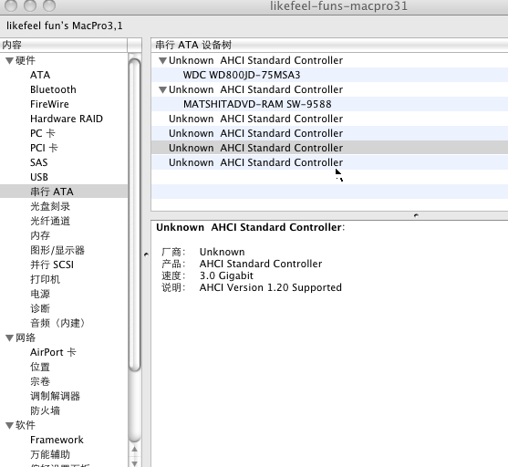

likefeel Posted October 6, 2008 Share Posted October 6, 2008 How to get the ICH10R AHIC work?? Link to comment Share on other sites More sharing options...

likefeel Posted October 8, 2008 Share Posted October 8, 2008 P5QL-PRO(P43)the ich10 not work????HELP!!! How can i let it work??? Link to comment Share on other sites More sharing options...
