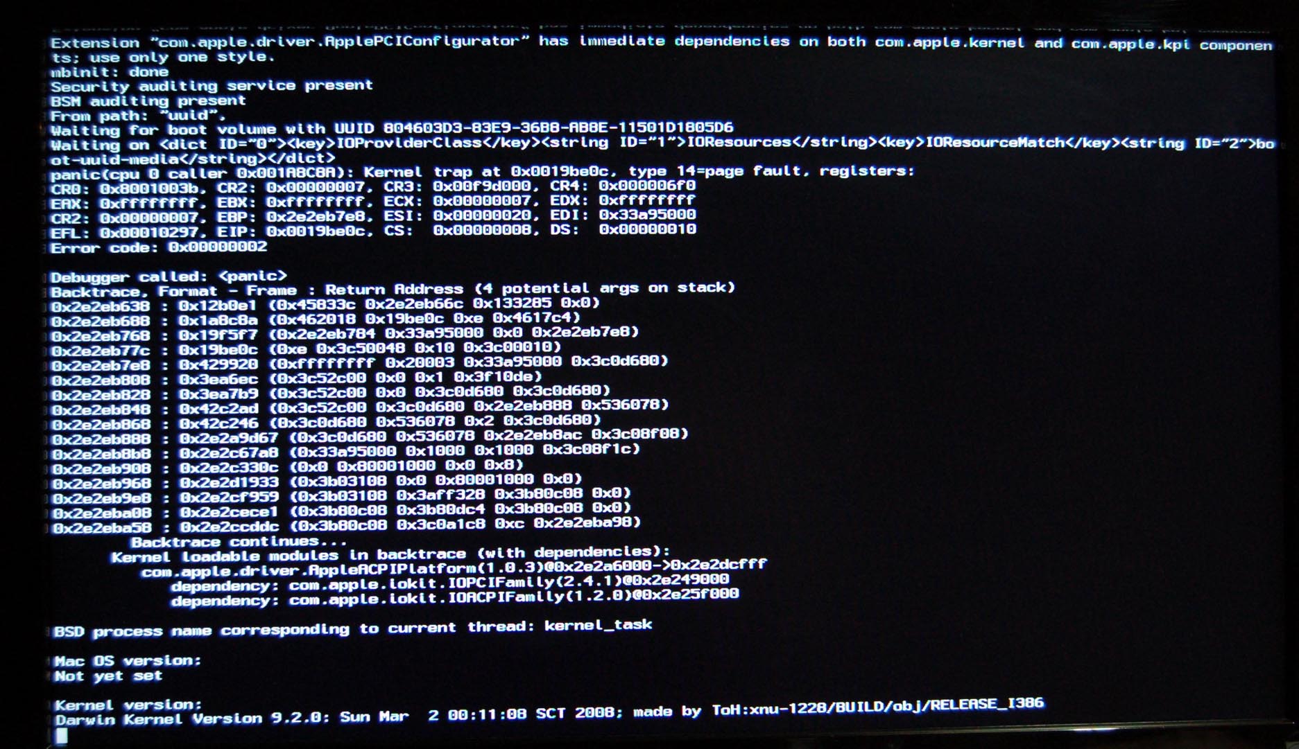

delo Posted August 28, 2008 Share Posted August 28, 2008 I downloaded the Kalyway 10.5.2 version, but when It starts It gives me this error : Mac OS version : Not yet set help please N.B. : I flashed my Bios with the latest version ASUS P5Q v1306. thanks Bitrip Link to comment Share on other sites More sharing options...

BiTRiP Posted August 28, 2008 Author Share Posted August 28, 2008 @Delo Did you DISABLE all the CPU FEATURES in the BIOS setup? And do you use AHCI in SATA setup? BiTRiP Link to comment Share on other sites More sharing options...

delo Posted August 28, 2008 Share Posted August 28, 2008 @Delo Did you DISABLE all the CPU FEATURES in the BIOS setup? And do you use AHCI in SATA setup? BiTRiP Yes of course. But for the feature, what do you mean Link to comment Share on other sites More sharing options...
BiTRiP Posted August 28, 2008 Author Share Posted August 28, 2008 Yes of course. But for the feature, what do you mean Well, I guess it's called CPU CONFIGURATION instead of FEATURES. (Speedstep, C1E, TM Function etc.) Disable it all except Execute Disable, set that to enable. Good Luck. Link to comment Share on other sites More sharing options...

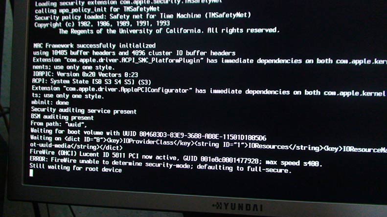

delo Posted August 29, 2008 Share Posted August 29, 2008 @ Bitrip Thanks Bitrip for your solution, I have a different errror "Still waiting for root device" for information I Use an IDE NEC DVD Reader. I it is neccessary to change it with Sata one? Link to comment Share on other sites More sharing options...

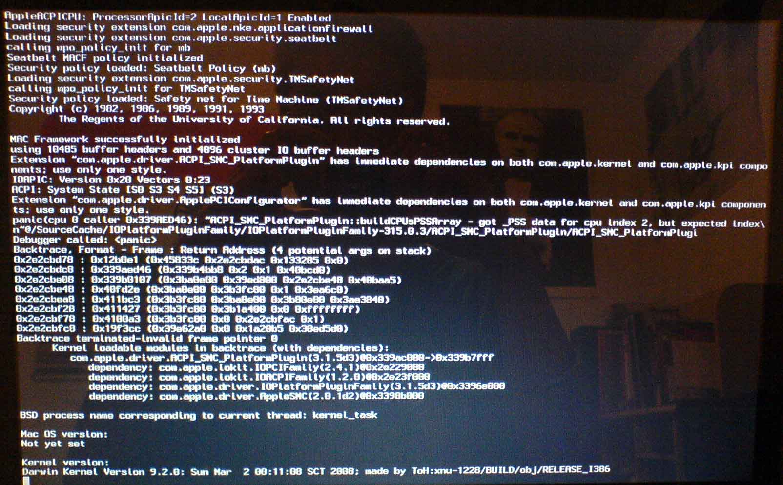

delo Posted August 30, 2008 Share Posted August 30, 2008 I have the same error, see my screenshot Link to comment Share on other sites More sharing options...
