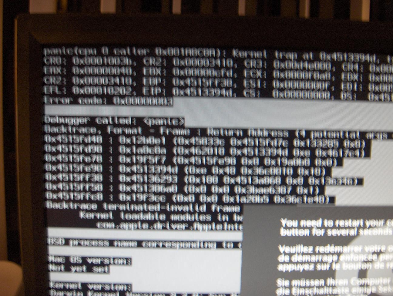

I was able to get Leopard 10.5.? installed from a flat-image file and running on my P4 Prescott 3.0ghz ABIT IC7-MAX3 mobo.
I tried the 10.5.3 updater and it finished successfully, but when I reboot, it flashes the gray mac screen then goes to black screen with a bunch of errors. In the updater I left all the default settings.

at press for f8 options screen, press f8, and type -v and enter... it should show all the errors... pls post that error screen...
most likely it will be a controller issue... i will make a special package for this issue with some packages from latest Jas DVD... so taht people will be able to use older drivers if the latest ones dont work for them or they dont have ahci support on their system...
I fed up with same problem reporting... so i will provide a solution very soon...
EDIT: I can somehow see a line saying AppleIntel... guessing the rest is AppleIntelCPUPowerManagement which is known to be problematic, however I dont know why you have it? or How was your system booting with it? :( You have to remove that and seeing your detail as just joined the forum... i suggest you to find transmac for windows, and use it to locate taht file in /System/Library/Extensions/
EDIT: I can somehow see a line saying AppleIntel... guessing the rest is AppleIntelCPUPowerManagement which is known to be problematic, however I dont know why you have it? or How was your system booting with it? -_- You have to remove that and seeing your detail as just joined the forum... i suggest you to find transmac for windows, and use it to locate taht file in /System/Library/Extensions/
