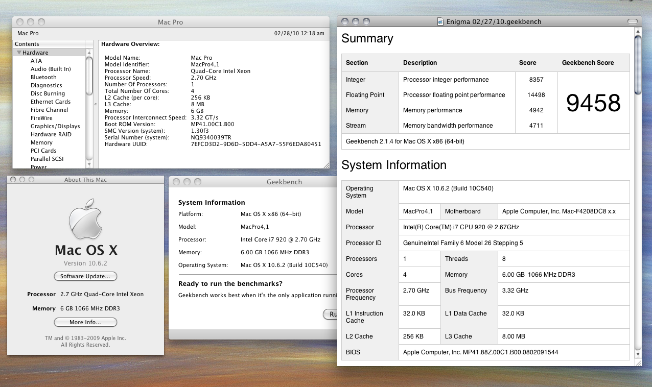

Here is an image of my build with this board, with Geekbench score (Please note that the CPU has been overclocked to 3.33 GHz).

My Geekbench image:

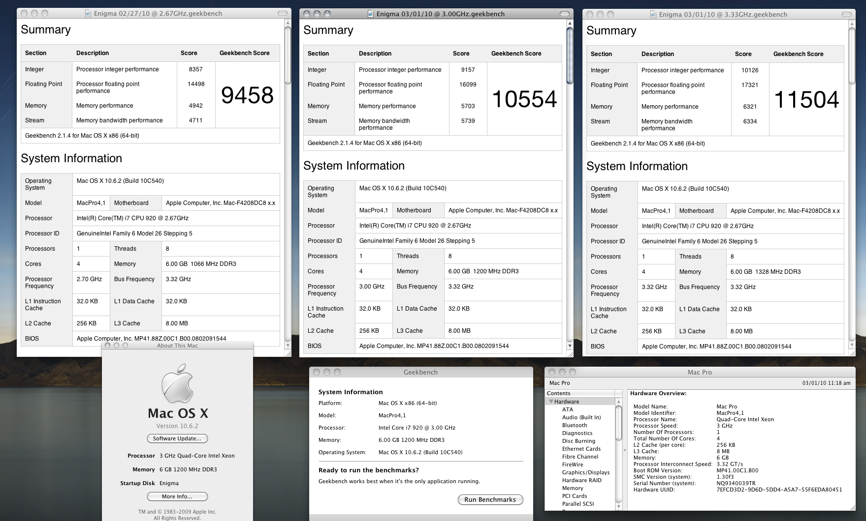

Below is a Geekbench comparison image of all three BCLK frequency overclocks:
