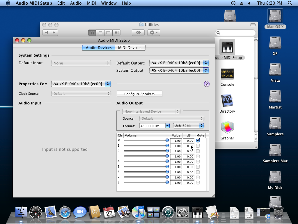

martisti Posted November 27, 2008 Share Posted November 27, 2008 Here is a picture of mine : In "configure speakers" it is on Stereo: on Left-1 on Right-2 but as you can see I can mute only "m" . the 1 and 2 are invisible. This is the reason I believe that I have no sound. Regards Link to comment Share on other sites More sharing options...
Oxtie Posted November 28, 2008 Author Share Posted November 28, 2008 Here is a picture of mine : In "configure speakers" it is on Stereo: on Left-1 on Right-2 but as you can see I can mute only "m" . the 1 and 2 are invisible. This is the reason I believe that I have no sound. Regards In earlier version of kX mac drivers, the release note said to upload FPGA firmware through Windows (meaning install kX for Win then reboot to OSX). It said you've to do this everytime, however current release adds "open Terminal and type 'edspctrl'. It should initialize FPGA firmware and any dock stations you have. Note that if you reboot after Windows, and you were running Creative drivers, you need to reset FPGA firmware. Type 'edspctrl -reset'. Use this command 'edspctrl -reset' if you don't hear anything after reboot or power-on." Maybe in future, this will be solved... Up to this point, its better to install XP+Mac (try searching google with MicroXP) which is more like 100MB. In my case I've xp+OSX Steps were quite easy, 1. Create partitions + install XP 2. Install BootMagic (comes with PartitionMagic) 3. Run OSX setup, open disk utility, right-click partition, Erase a partition + install OSX. 4. after reboot WIN will start because of bootmagic and inside WIN, open BootMagic, add another bootable parition + press "save.exit" button and you are DONE! Link to comment Share on other sites More sharing options...

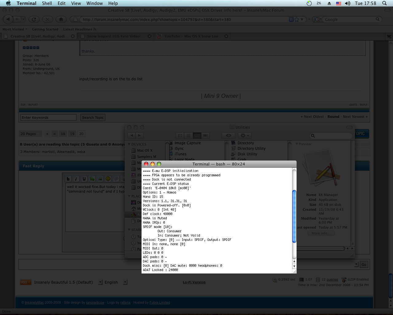

martisti Posted December 2, 2008 Share Posted December 2, 2008 well it worked fine.But today i start the system and there is NO sound at all from EMU 0404. I tried via Terminal with 'edspctrl -rese' but it answers: "command not found" and if I type 'edspctrl' it answers" FGPA firmware already initialized and DOCK POWERED OFF!!! Link to comment Share on other sites More sharing options...
Oxtie Posted December 3, 2008 Author Share Posted December 3, 2008 well it worked fine.But today i start the system and there is NO sound at all from EMU 0404. I tried via Terminal with 'edspctrl -rese' but it answers: "command not found" and if I type 'edspctrl' it answers" FGPA firmware already initialized and DOCK POWERED OFF!!! well I'm not sure much about emu series, but did you try restarting XP again and then OSX? you never know what works If it doesn't, click on the Bug Report link (found in my signature if you're logged in) Link to comment Share on other sites More sharing options...
